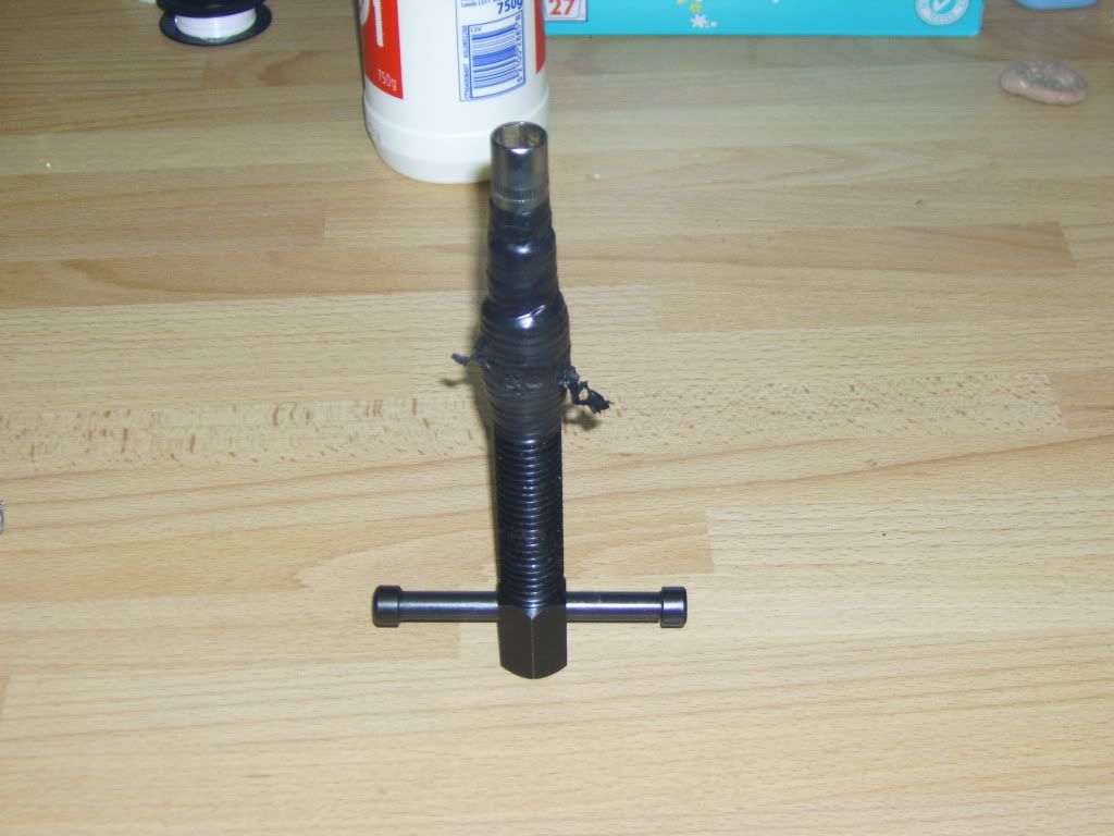

i made a clutch alignment tool, all it needs to do is hold the clutch plate in place while you put the clutch housing over it and bolt it to the fly wheel.
with my zed i used a socket that was just big enough to go into the crank hole, and then electrical tape around a break caliper piston pusher (not sure on the exact name lol) until the clutch plate would sit on it central. worked a treat.

hey vodkashots,
thanks for that piccy, i think i cud manage to make sumin like that, i mit have a bit of bar or a long socket extension around that i can tape up,
