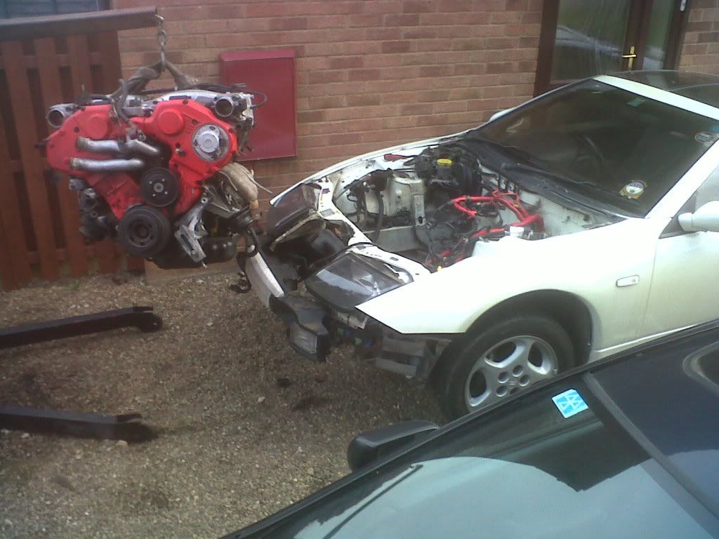

And to finish off the day we took the engine & autobox out of the white NA ready for a fresh engine and manual conversion, NA's are soooo easy to work on lol :clap:

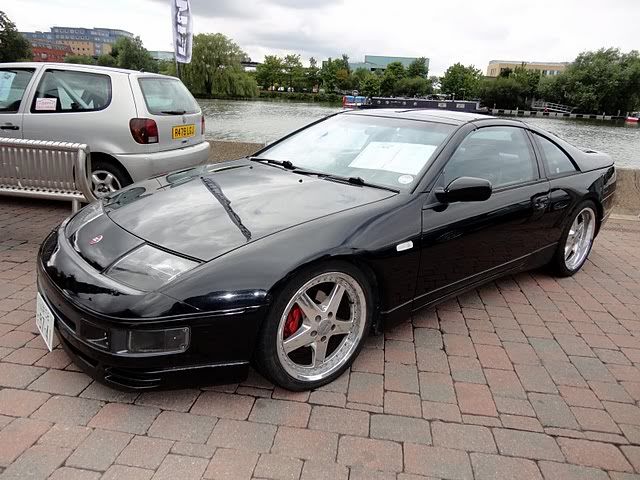

and a pic of the black one to help me get interested again lol
