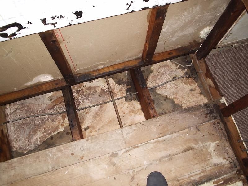

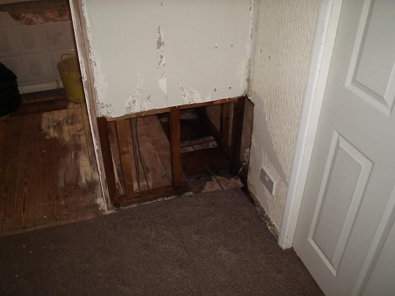

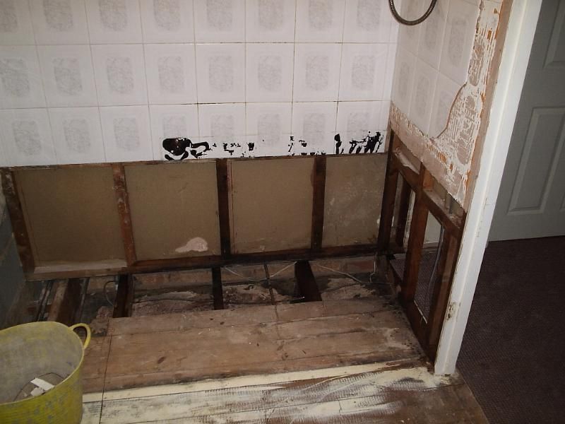

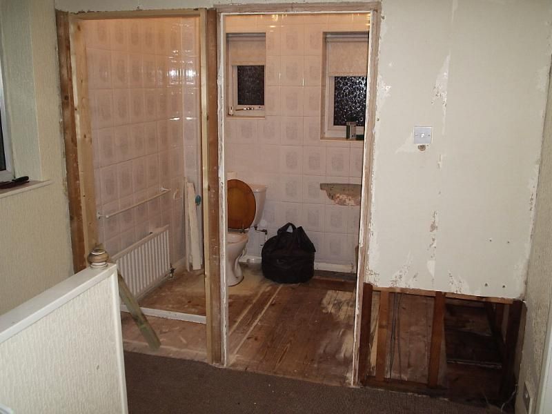

The latest bit of the house to get done!-Good timing as well, seems the bath had not been sealed properly and the stud wall/plaster as wet rot!
Just started to get into one of the joists too! so here we are.........
How the plasterboard held up I don't know LOL!!

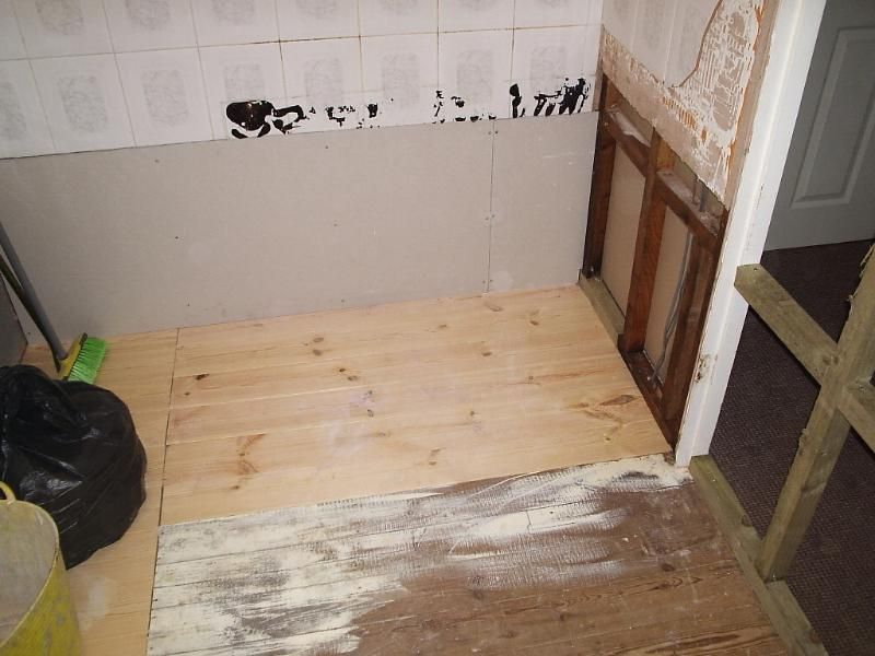

All treated and rotten bits replaced and new floor boards going in...

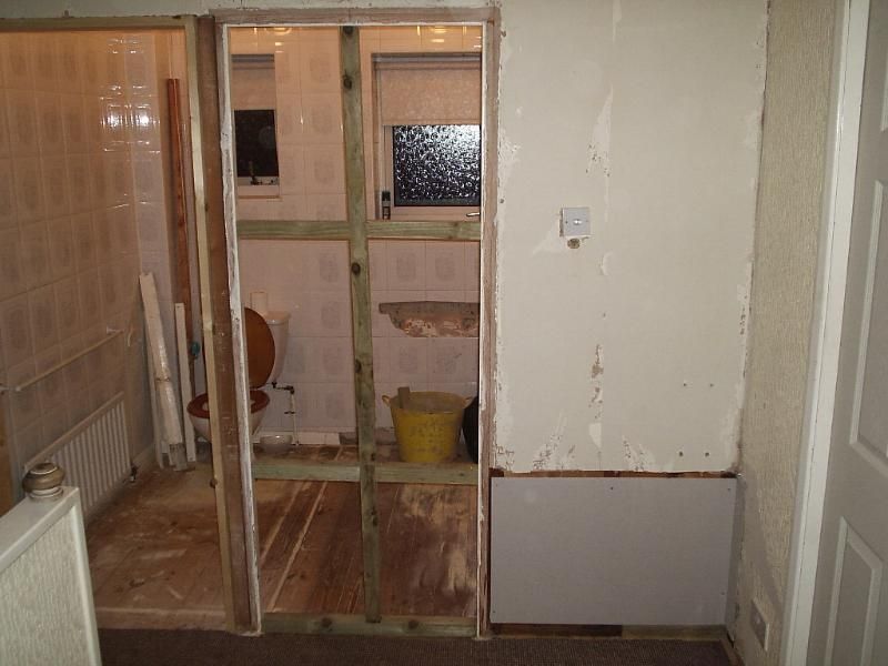

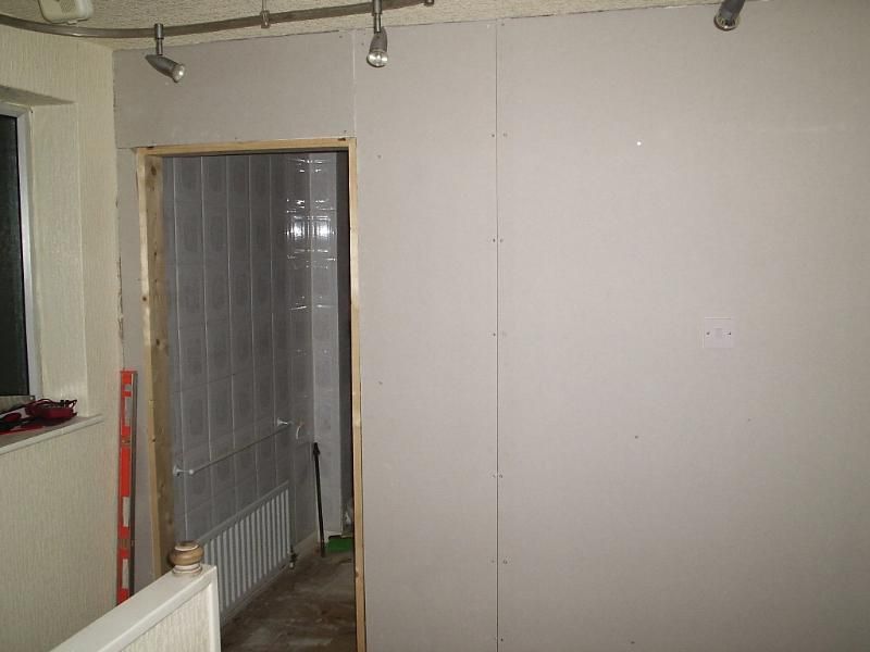

Also moving the door to allow a bigger shower enclosure (cos' I'm a fat git lol)

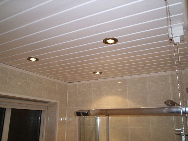

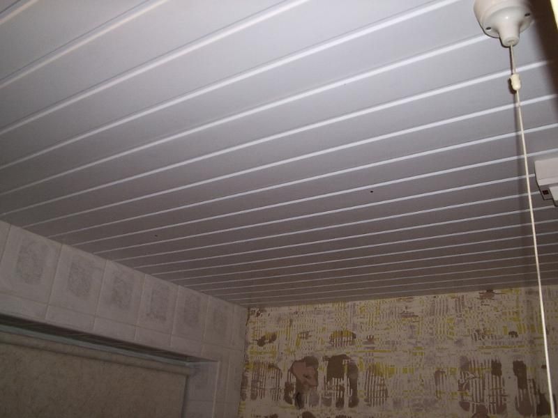

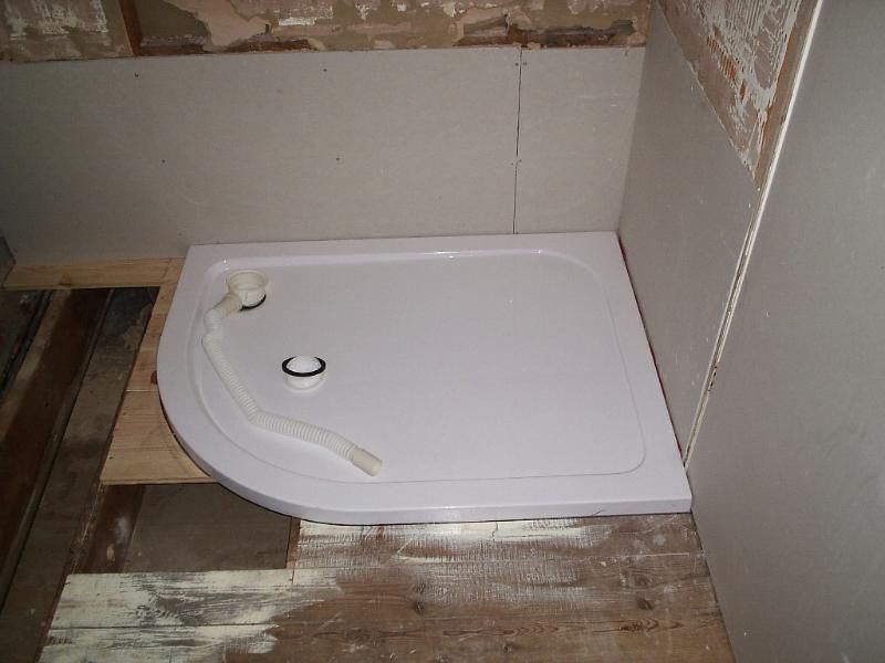

Got the tray in Today and the ceiling cladded,also cladding the walls...
Good job we have the wet-room Downstairs as this is a longer job than expected!:ninja:

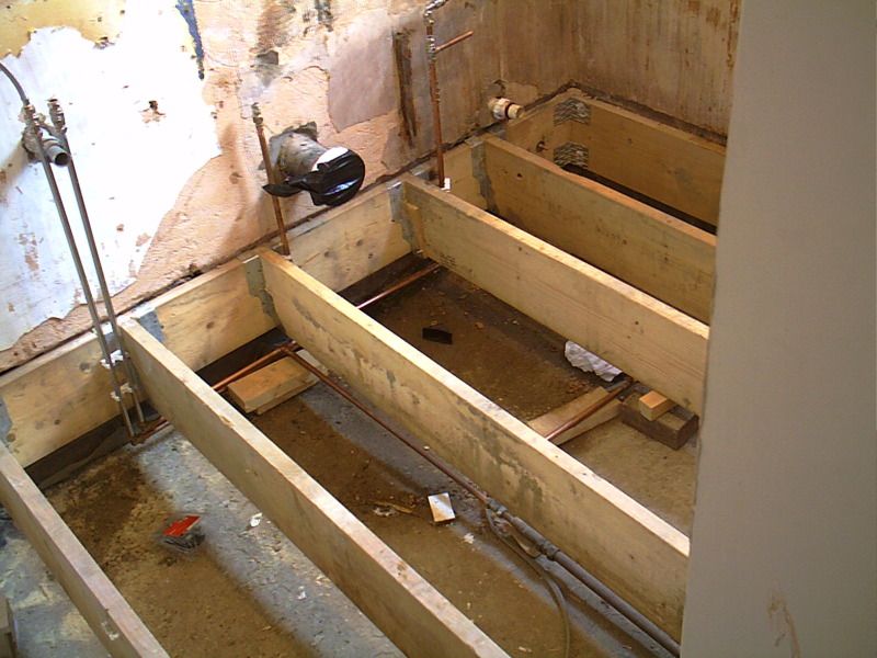

also, that waste has a 22mm pipe off it, it look's like a bath overflow pipe
an it look's like the waste goes through where there is a joist, thet will be a bit of a pig to get round, you can cut the joist away but not too much

you can get aquapanel cement board (like plasterboard but a bit more expensive) to use in damp places such as showers, behind bath etc not absorbent like plasterboard and you can still stick tiles directly to it. Also make sure if you use that flexi waste pipe that it is well supported to get the drop you need. It will sag and cause run back into the large shower waste which doesn't have a proper trap possibly causing the shower tray to fill up rather than drain away. It's preferable to use hard pipe and bends if possible.
LOL!-no bath mate,just a shower,that's a 90mm waste for the tray.It falls smack in the middle of the joists-lucky eh?:yes:

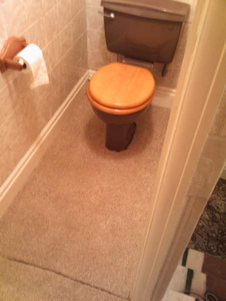

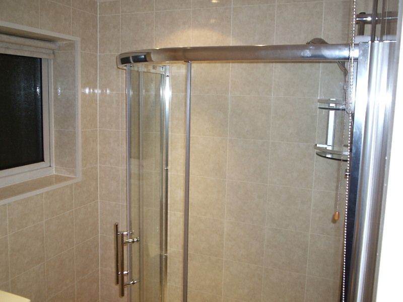

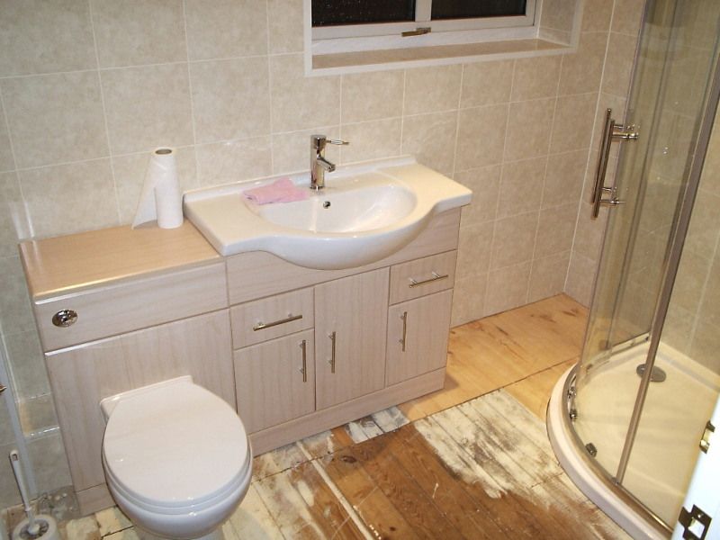

Well,just waiting for a Carpet but it's about done!-Now onto the Hall/Landing/Stairs! OH! the Joy.........
:ph34r:
That looks great! Fab job. Er, but carpet? In a bathroom? I hope you do wee wees sitting down as I've never met a man yet who doesn't accidentally miss at times! Nice bit of lino mate lol
Always had Carpet Jane, like the comfort and after living in Spain,Tiles and Lino etc are out-Bloody lethal!!:whistling:
Only if you've had one too many sangrias lol!
You must have a very careful aim :w00t:

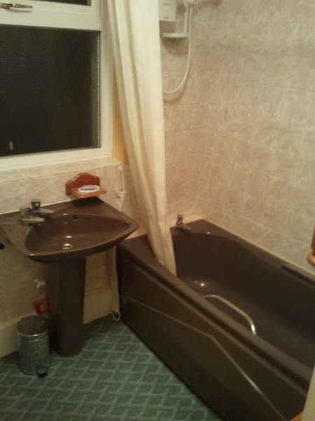

Looking good mate! My bathroom is my next project - well a friend of mines lol. I'll assist fetch/carry etc whilst he makes it look awesome. As you can see I have some distance to go... hehe
C'mon how retro is that :crying:
Very much hope you don't bring girls back..haha :whistling:
Haha no I dont, no GF either so im the only one that gets to enjoy it! I've actually recarpeted it from scrap from the other rooms which has improved it and got rid of the hot water tank cupboard. New boiler went in two weeks ago so thats all gone.
Although its still bloody awful! I cannot wait to get it done.
This is what I'm going for with it I think!
mmmm Chocolate Brown bathroom suite, erm YUK! lol I still remember my nan having almost the exact same bathroom suite back in the 80s, hated it then too! lol

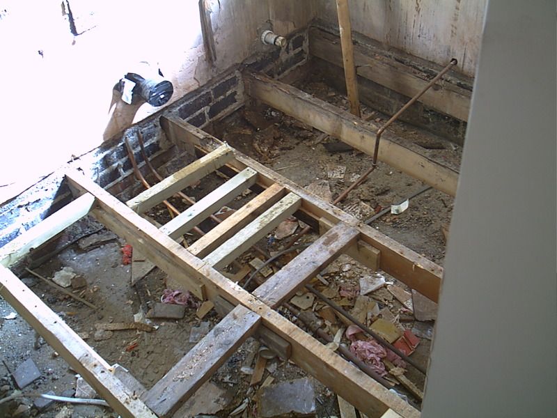

You wanna see a rotten floor and puny joists , this is what i found when i ripped our bathroom out , it,s in an extension on the side of the house , whoever built it needs sacking !!!
You can see the floor dipping .
When the bath was filled it dropped about 10mm , not surprising when i saw the so called joists !!
And this is what i replaced it with , the bath doesn,t sink now !lol
