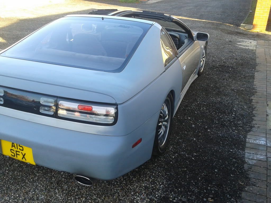

welding is your best bet. easy to do. i did my own like this:).
Nice job, IMHO that looks smoother and nicer than my tailgate skin.
