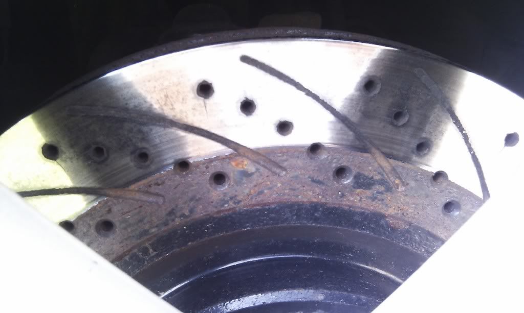

Yeah that photo isn't pretty, but it wouldn't affect performance, it'd just look ugly, lol. Obviously the ultimate solution is bigger discs + bigger callipers + better pads, but better pads and bigger discs with the grooved and drilled feature of course, would be a lot better than standard. I personally have done as Black Zed has done, I've got drilled and grooved, standard size discs all round, car stops on a 6 pence, but when it comes to track use I think they will heat up too quick to continue the performance :( Certainly had NO issues on the road though.

Yea that picture was on my Zed when I got it and I changed them for a set of standard sized drilled and grooved. I reckon theres no difference between the two (on the road that is) but as you say the track might be a different story :)
Never understood the whole drilled discs thing, you can clearly see the cracking around the holes in that photo there, do not want!

PerpetualZero what disc size are those in the picture mate. is that the db power kit?
Sorry I couldn't actually tell you mate they were on it when I got the car and I never measured them.
When I took the pads off they were only half in contact with the disc, so all the hype about the braking force being more due to larger disc size etc. fails to take into account only half the pad is in contact with half the disc.
I'd assume that if you have the right size re-locating bracket for the calliper, you should see the entire pad touch the disc, but only part of it, either way, I reckon the braking power will be the same with a larger disc and standard calliper, as the physics involved, is forgetting that the pad is still small and so is the force that's pushing the pad onto the disc.
