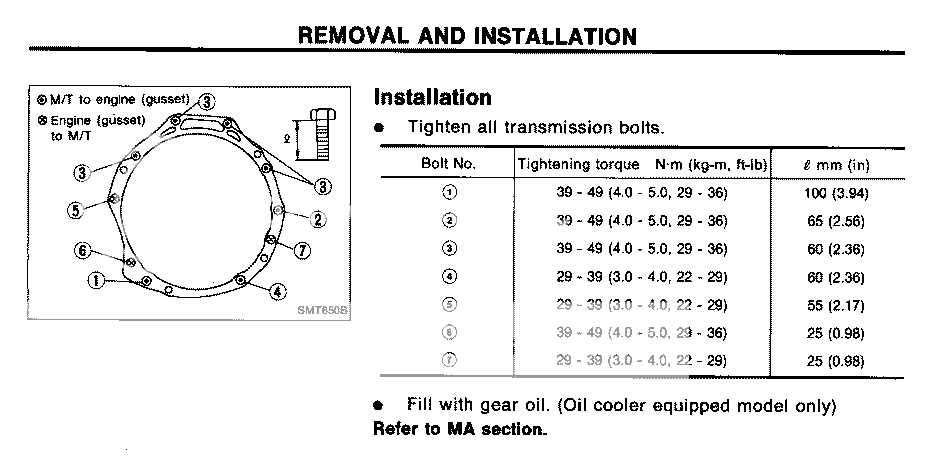

This may be a little odd to some. But does anyone have any pics of which bolts are for the gearbox??.
All mine are mixed up in a toolbox and would save a lot of hassle to have a picture to compare with when trying to find all the correct bolts to refit the gearbox on.

Thankyou tudor. That will be a great help.
