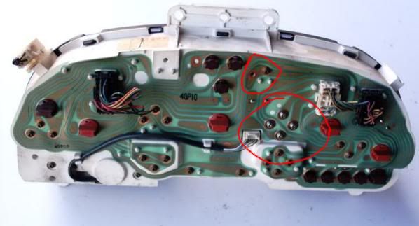

Best pic i can do for now, will try again in the morning.
99% sure there's no black box stuffed down the back but if anyone can throw a light on whats going on that would be great.
Check the connections screws are all in place, the 4 in the lower red circle are obvious but the top single screw can easily be missed.

All four screws in the back of the dial, the screw in the smaller circle is in the other hole, tried it in the one in the picture but it wont go so didnt want to force it and break it. I will try again in the morning.
The screw in the top hole will be where it is in the pic for jap clocks (100k) and the UK clocks the screw is in the hole next to it (10K) Try banging the top of the clocks when going along, if you have any movement or intermittent needle movement, then likely a dry joint on the speedo board. Give the wires to the white plug a little tug to make sure they arent loose and check along the loom line for an obvious slice/break.

Speedo board out of the binnacle and you would normally get the dry joint around the R10 resistor area, but look at the tracks on the board for dull solder or missing solder.
Flow new solder basically will sort out the dry joints. Good bit of info here http://pexcom.com.au/z32cms/e107_plugins/content/content.php?content.321
