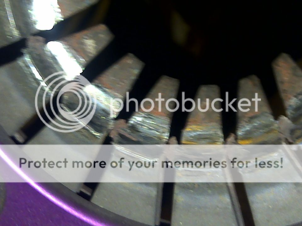

Is this repairable?
Is this repairable/refurb-able?
The rest of the clutch is in pretty good shape.....
It would be a shame if the clutch was a right off just because a component (that looks to be replaceable) was fubar'd
If a garage could repair it/grind it etc then that would be great but if they can't and if Exedy don't do spare parts then it's a bit naughty really 'cos that's effectively a two grand clutch gone to waste for no real reason
I didn't pay two grand for it, Marty threw it in as part of the deal when I bought the shortie' but a new one from Z1 is over $2200 + taxes etc, so not cheap
if I can find someone who can repair it then that would be ideal
Sure it can be fixed as the fingers are replacable on most covers cannot see why they would not be, depends on if a clutch company would want to do it rather than selling a new unit, if your interested I could ask our clutch manufacturer, I expect they would want to see it first though.

If you could mate that would be great. I've sent an email to Exedy to see if they stock spares but not holding my breath if I'm honest.
Would the guys need the whole cover or just the fingers?
cheers bud
Ok well Exedy have said that they don't offer spare parts though Z1 have offered a replacement cover for $330 + shipping.
Strange question but has this already got a flywheel attached?
