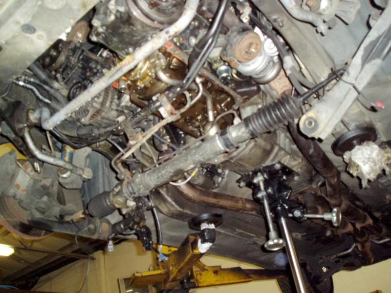

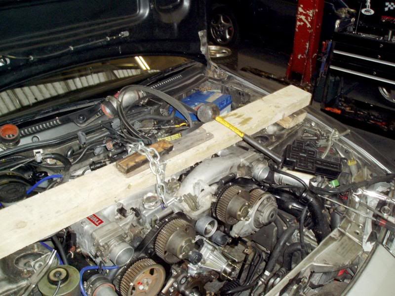

The engine was supported from above and the subframe completely removed, then the sump was removed and now we could see what was happening.
Sub frame removed
Sump Removed
Unfortunately this told us less than we had hoped, the pick up tube was clear, the pick up tube O ring was correct and new, the oil filter ( Nissan ) was fine and had been changed anyway early into the checking.

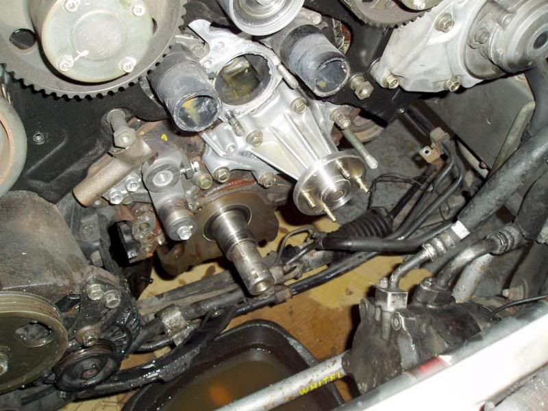

So with heavy heart I knew we needed to remove the oil pump to check the gallery to the oil filter from the oil pump, so the front of the engine was stripped again! this then gives enough access to then remove the oil pump.
Very quickly it was established that the gallery was clear as it should be and the pump registration onto the crank was fine..... time for another cup of tea!

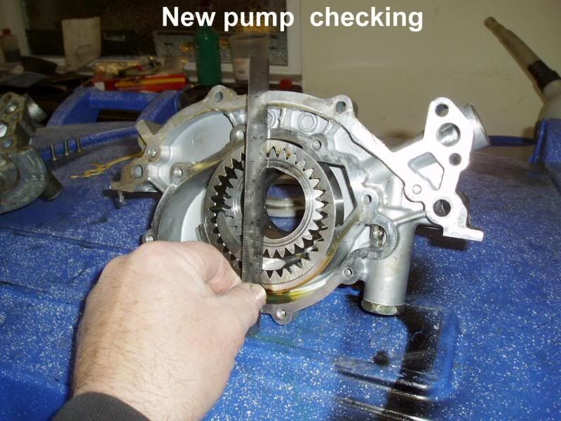

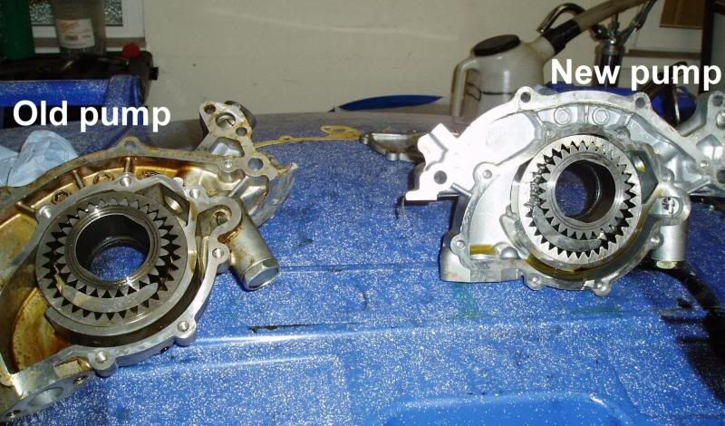

So here we have an old pump and the brand new item along side each other,

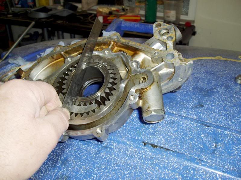

Based on a hunch and a damm fine cup of tea we removed the new oil pump back plate and also removed the old pump back plate for comparison.
The old pump was checked for tolerances between the pumping gears and between the outer gear and body..and was remarkably in good nick, in fact well within tolerance and actually re-usable if you wished too.
The new pump was also checked and the gear to gear and gear to body tolerances were found to be ok, note I said ok not as new? however when the gear edge levels were checked they were found to be under spec by quite a margin too?? we removed the gears and found them to be undersized, not worn ( new remember) the fault had been found and was actually a manufacturing fault!
So a replacement pump and rebuild back up and problem gone! I can say I have never seen this before and even spoke with Jimmer ( thanks matey) and its well unheard of to have a faulty oil pump from brand new.
