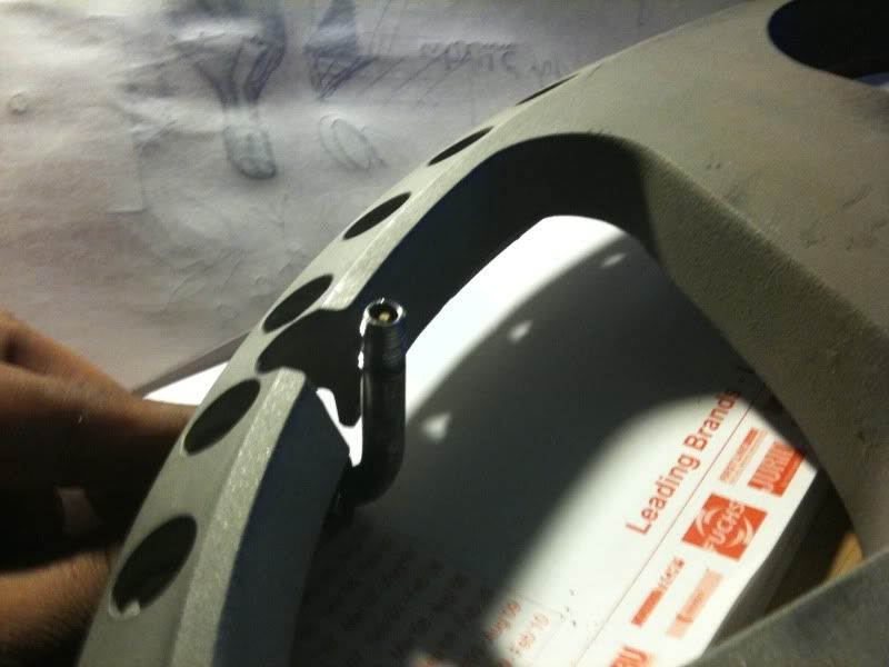

Finding it really difficult to get air into the tyres because the valves are so close to the alloys. You cannot get the air pump attached.

In all seriousness, are you having trouble with the L shaped pump valves? If so, you may need "L" shaped tyre valves, which most tyre fitters won't stock.

Problem is the valve is too tight to the wheel so cannot get the adapter on a foot pump or garage forecourt properly onto the adapter.
It it was 5mm longer... haha
Maybe if you get a hand pump adapter thing, you might be able to screw that onto your tyre valve, and you can have an extra 3" of valve :p

I bought those plastic attachments from halfords. They screw onto your valve and extend it out.
