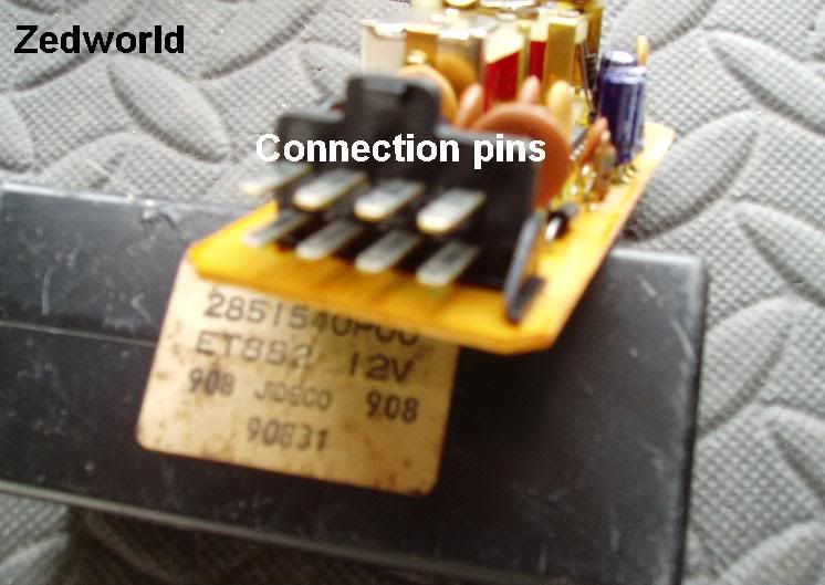

Photo 2 shows the unit end up where the connector goes in and again the source of most issues the unit suffers from.

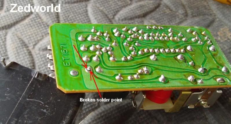

Photo 3 shows the rear of the pcb and the area in red is where the connector busbars are soldered to, not easy to see the problem yet.
Photo 4 shows the problem in clearer detail, the pin solder has failed and this is the cause of the intermittent or no connection and the failed window operation.

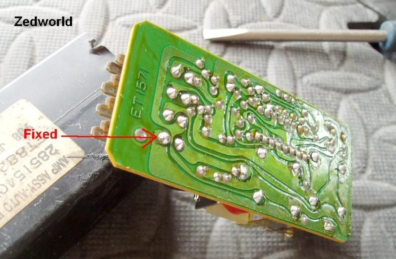

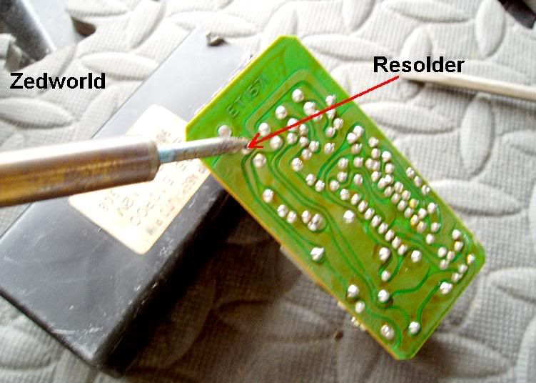

Photo 5 shows the method of repair, by applying a soldering iron to the effect area the solder will reflow and make a new connection.
Photo 6 shows the final result, a nice solid connection that will get that window operating again, just put the unit back together and refit to the door.

Ok i've had a look at the amp - and as the pictures show, it looks like a previous owner has soldered it before. Correct me if im wrong, but it looks like it's soldered ok, so im unsure what the problem is?

looks too me that one or two of the other joints are suspect,:detective:
they appear to have a circular break around the solder.
particularly the one 3 above.
May be worth just re melting the joint, but be careful not to over heat.

Ok will give them both a solder. Does the passenger side need a window power module too??
Here you go, all revealed in close up, get your soldering iron out! and the passenger side window does need the unit in place.
