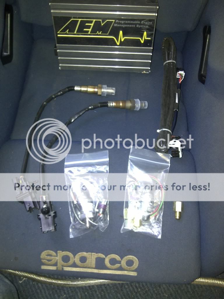

Ok, well this is what I've got
Like I said before, the series 1 should be fine for what I've got planned

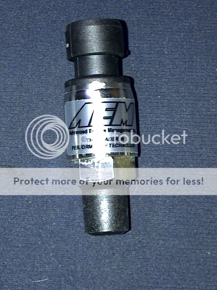

The AEM part is a 3.5 bar MAP sensor with a screw thread

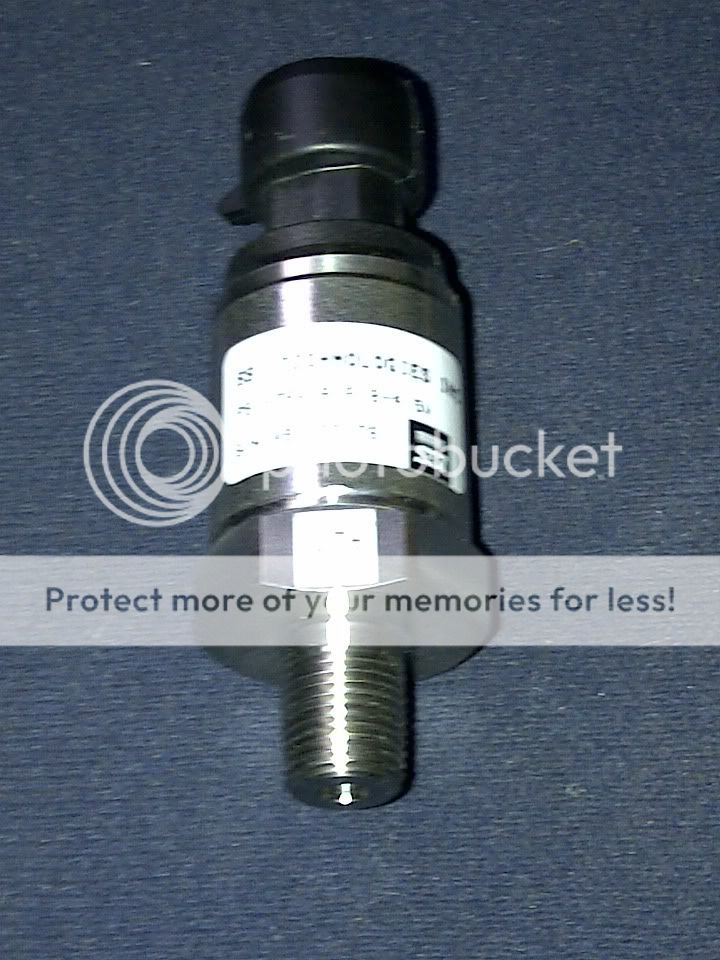

the other one was supposed to be an AEM part (though there are no AEM markings on it) it's a 5 bar MAP sensor.
I'm assuming the 3.5 should be fine?
with regards to the AEM Lambda/Uego sensors, I assume that they just replace the current sensors mounted on the downpipes?

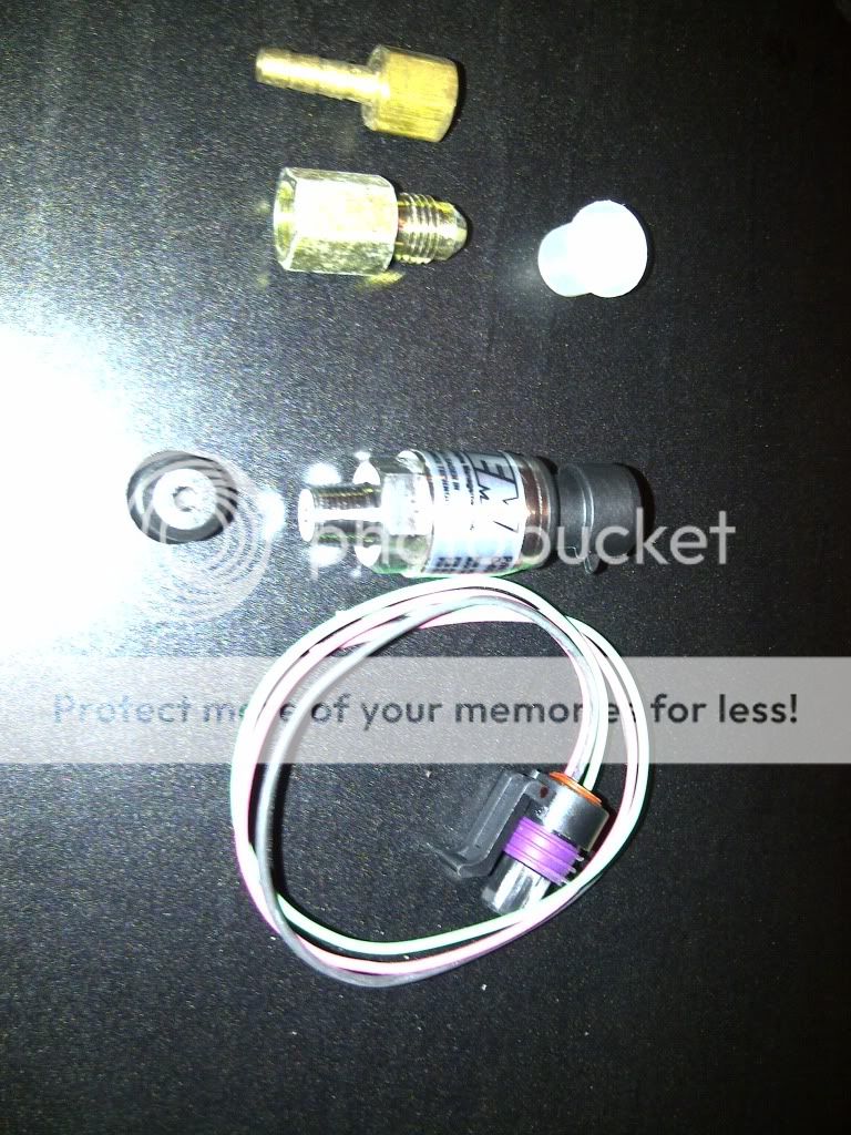

Sorry that wasn't a very good pic with the end cap still on
yep as i thought map sensor is a screw thread its not like a boost sensor should be able to use the PVRV hole as i said

Can't see yer pics due to work firewall, but yes 3.5 is more than enough.
Uego sensors to be a 100% accurate should be in the manifold, this is not easy and can be fatal if one falls apart, so as close to after the turbo's then, existing holes yes.

Where does the MAP sensor get wired into? I've connected the sensor to the supplied cable but there are 3 bare end wires (Ground/5v and Signal) that obviously go somewhere, I assume these need to plug into the EMS somehow??
