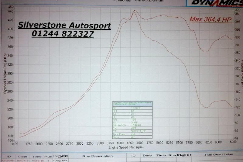

Hi guys only just had time to get this posted,maybe this means more to you guys than me,this was a dyno day organised by HollandRob from the forum great day first time i have done this if you get the opportunity you should do it.
Here you are brightened up a little.

looks broken to me, peak power at 4200 and flat as hell after that?
Well like i said zed world done a great job on my upgrades what ever the dyno says i am well impressed with my prefomance so cheers zed world.:wink:

That dont look right are u sure the dyno was set up properly? Have u got a printout showing boost/afr?
i am sure the dyno was set up right?
Sorry im only askin coz the AT and IT are the same most likely meaning they didnt put the temp probe in the air filter like they should? Did they hook up afr/boost?
