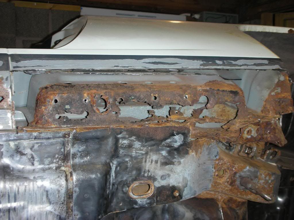

just finishing a big shell overhaul, the sills etc looked good from the outside, but a different case once you peal back the outer skin.
my targa drains were all still intact, the obvious problem is the factory wax protection. where wax has been applied the panels are perfect but as the rear sill section are very complex (up to 5 layers in places) the factory wax has missed and the metal dissolves.
if they are still good inside (WHICH I DOUBT) then some more wax will do the job.
the sill areas are always going to be exposed to moisture and with no real airflow through them they are a perfect breading ground for rust, once it sets in little will stop it.
have a look at redwines rebuild thread for a good idea of how much it will spread
