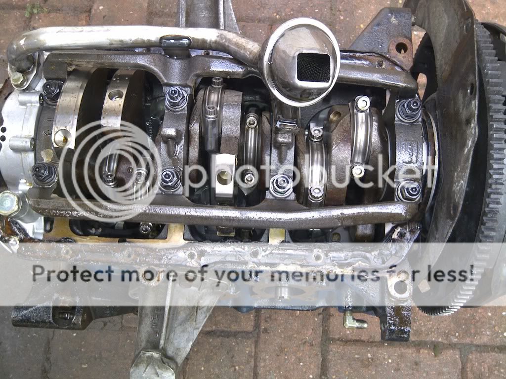

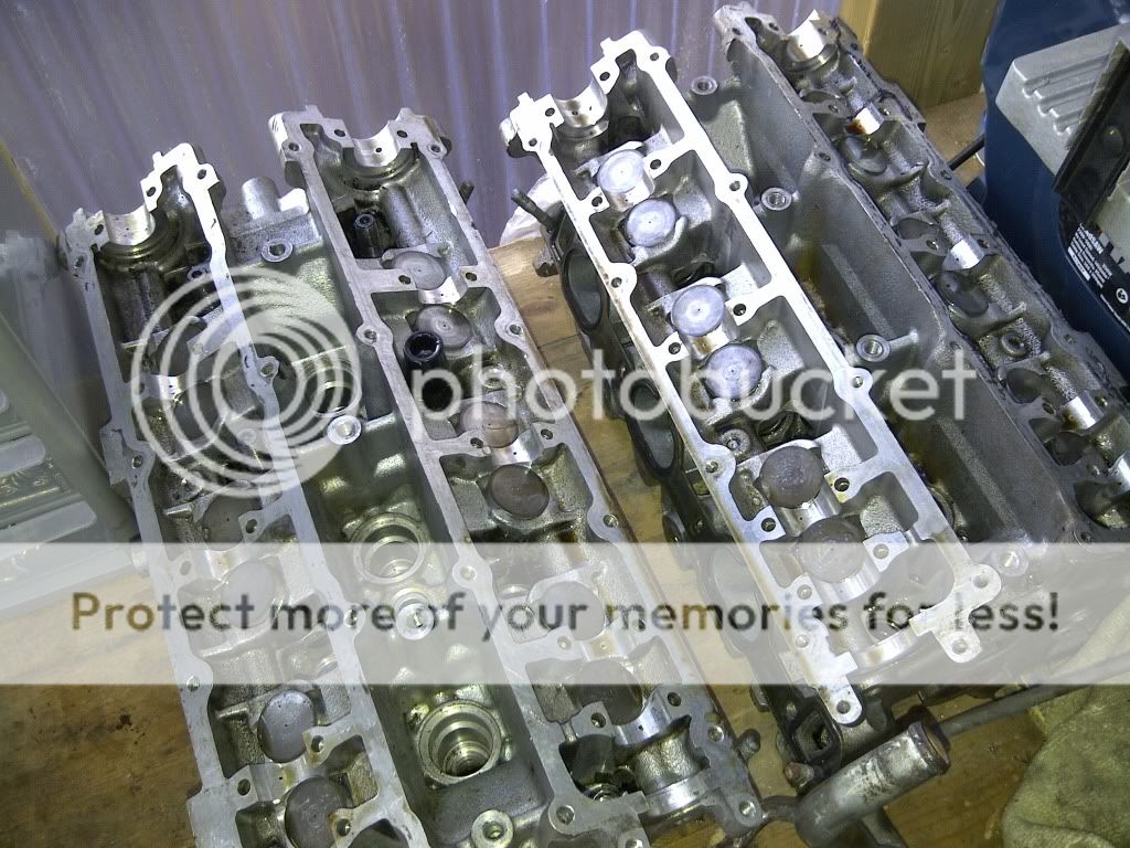

Eventually I've managed to get the engine out of the LWB zed, without the benefit of an engine hoist and with every nut and bolt seemingly taking the p**s, it wasn't the easiest job that I've carried out on the old girl, but hey it's done now....all I can say is thank God for creatine!
*The internals are forged carrillo and Arias parts thank God*
the hardest part was carrying the bloody thing on my tod through the house and garage without dripping oil everywhere

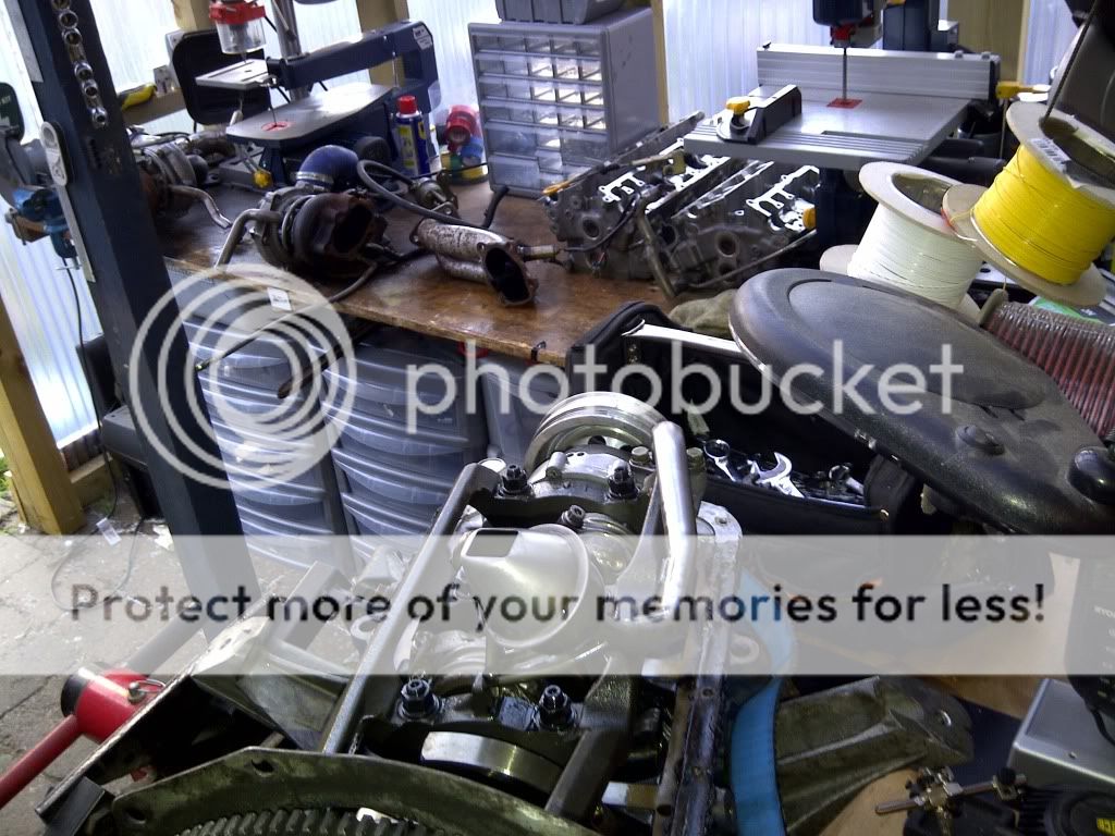

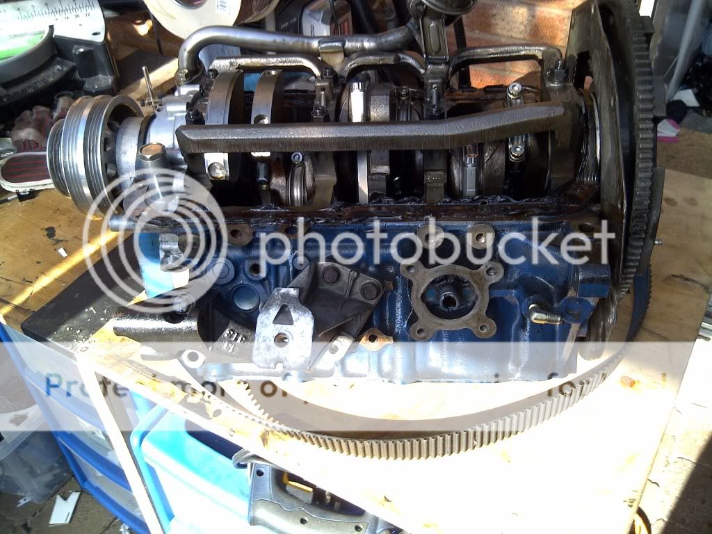

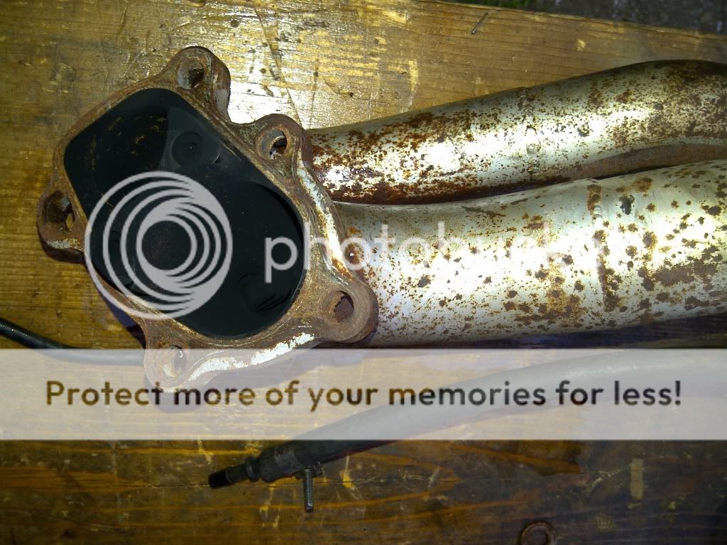

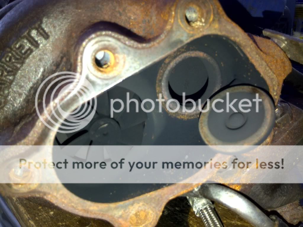

anyway, it's currently up on the work bench but I'm planning on putting it onto the engine stand in the next day or so, which would give me some spare work space to strip the rest of the engine; the downpipes are still attached to the turbos and two of the nuts have rounded off so that's more fun to be had....
any suggestions as to where the mounting points are on the block?
I'm assuming that large bolts are required to mount it in place?

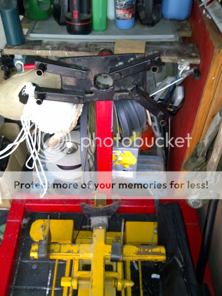

here's a pic of my engine stand

it should line up with the holes for where the bell housing bolts to then its just a case of nuts and bolts

I've already started the strip down in the workshop, it's amazing how much easier it is to strip parts when they aren't fitted to the car.
for example, I've just undone the last 4 bolts on the pair of down pipes, I'd been trying for bloody hours to get to them whilst they were on the car and ended up giving up in the end, once off the car.....2 minutes!!
