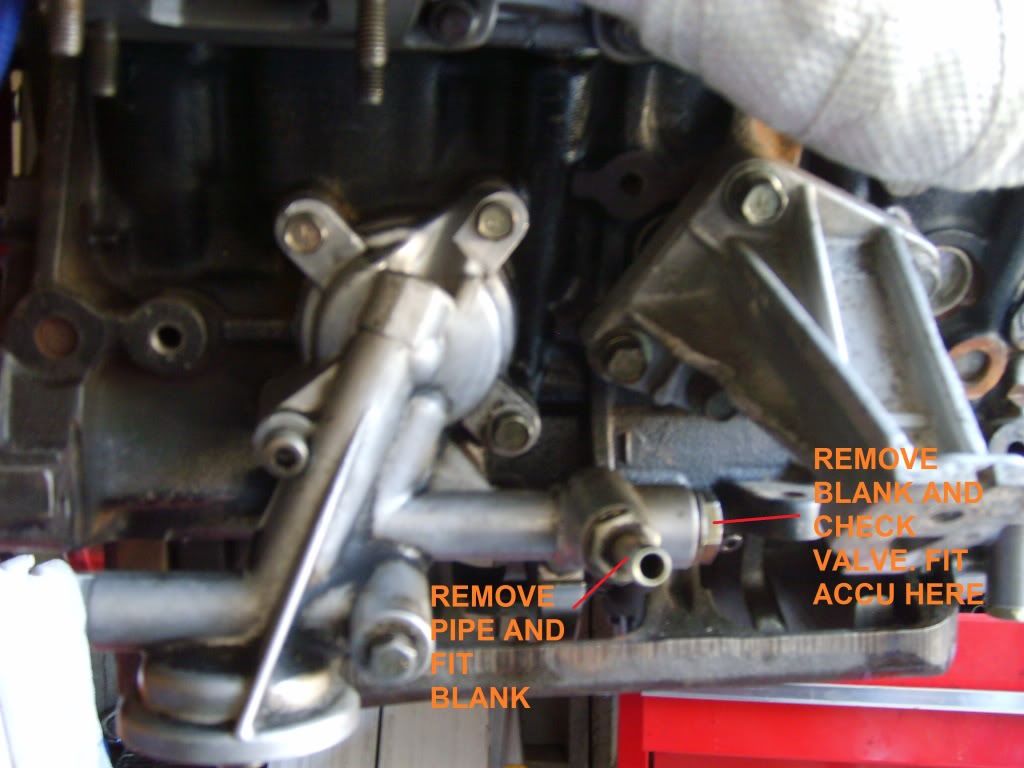

if you look here all is explained.The sender should be screwed straight into where the blank plug was on the filter tree.it does fit,ive done it.if you look at the pics youll make out the sender.http://www.z1motorsports.com/imageGallery/main.php?g2_itemId=79592
This picture shows the blank in question better, stolen from elswhere on the forum so ignore labels!
Yeah, unfortunately the hardware that Z1 supplied with their kit doesn't leave enough room to fit the sender directly into this location. I've fitted a 90 deg elbow and ended up with the sender perilously close to the RHS turbine housing, I'm sure it won't last long here but at least I can check the pressure at startup, I'll get an aftermarket solution if necessary :-\
