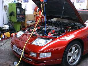

Just take it to a garage and they will hook it up to a R2D2 type thing, it will pull out all the old gas and put in to the top some fresh.
I got mine done last summer, simples and it was £35.00.
FYI, mine is a late '94, so same as yours :cool3:
I did a thread on it somewhere with the droid in action!!!
EDIT : Just search R2D2 and it will come up with pics

Here is mine been done 5+ years ago, still ice cold now.
Jeff TT
