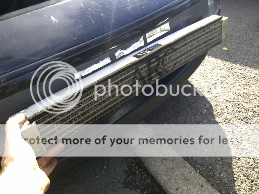

My shortie' is currently still fitted with the original small Jap spec oil cooler. It appears to have worked fine this summer but with a few choice mods on the cards shortly I want to upsize the oil cooler as a precaution.
At the moment I don't really want to be fitting sandwich plates, relocation plates etc and am looking at the simplest way to fit this cooler (below).
The braided hoses fitted to it are huge, AN12 or AN14, and I want to plumb it straight into the stock oil lines/hoses.

I think the design of this cooler will work well with the stock bumper

i have a mocal on mine but that came with rubber tubes and fitted strait on to the existing, if you cut your fittings of and fit an end cap they should be fine
Cheers bud, that's what I was thinking :thumbup1:

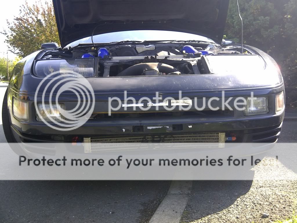

Wouldn't mind your input on these two options for oil cooler location
In the bottom of the front bumper as discussed previously to recieve good airflow
or Bosozuku style fixed to outside of the bumper
not exactly zed purist but a bit different and arguably more effective, if a little impractical
thoughts please
It's standard location for me mate, for my taste the other 2 are too mental.

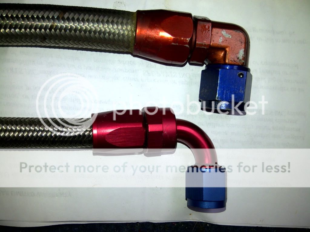

I'm struggling to find a sandwich plate for the zed that will fit this size AN connectors.
The pic below shows braided hoses to fit a regular sized Mocal sandwich plate (bottom) and the larger hose and connector for the ARC cooler (top).
This cooler came off a Time Attack BNR34 GTR, even the hoses themselves are massive.
think in side the bumper would look best, to big for bosozuku style + that's how i want to do my retro and i want to be the only one:whistling:
Fair one mate, I think I'll go for inside the bumper anyway as there'll be less chance of it getting knocked off or damaged
