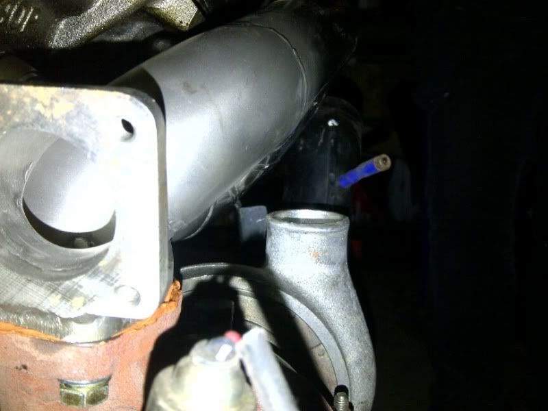

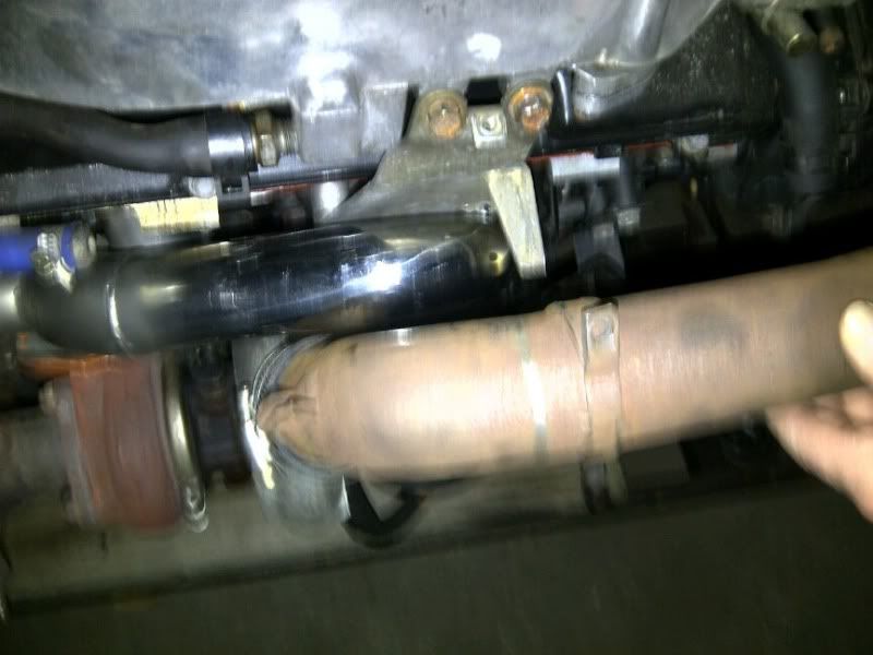

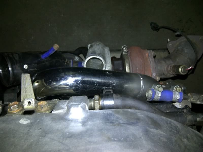

I'm ready to throw in the towel on zedding with this like. It's doing my head in. Below is the images the garage have sent me of drivers side turbo outlet pipe from various angles. As you see the pipe cannot line up properly because the manifold sticks out.
He wants me to advise how to proceed and I just don't know what to tell him to do at this point other than just get it done somehow.

A garage cant tell you how to sort the problem? Id find another garage common with aftermarket turbos the hosing needs to be rotated slightly which is down by releasing the clamping bolts on the impellor side or the turbine side of the turbo then it will move that out of line of the manifold. I had to do it on a set of T28s not long ago.
IIrc kits were available years ago for those,Youll have to get the garage to get some pipes and hoses.Speak to AnthonyD on here for the hoses and get a stainless steel exhaust place to make the pipes.You could first make them out of plastic pipe to get the angles right then use them for patterns.Sounds like the garage isnt really trying to hard to get the work done though.
And get them to heatwrap those manifolds too.
Thanks both of you. I spoke to nend about this as he did modifications to some of the pipes etc and supplied the manifolds. He pretty much just said the turbo housing just needed to be turning like 5 degrees.

I just spoke to Duncan. He's telling me they're having a nightmare with it because now the pipes are sitting 2-3inches further out than they would normally which would probably be right because of the turbo housing being turned. He's not sure if the engine will fit back in ok as thinks there might not be enough room.

everything will fit the pipe may not secure back onto the plenum side bracket but that doesnt matter

Spoke to Duncan today and he's advised the engine won't fit back in and that the Pipeworks needs to be made up.
