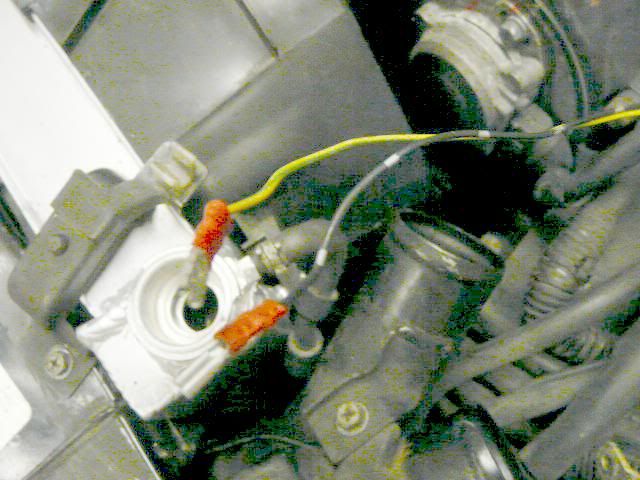

  • 3 weeks later...
Not getting anywhere with this:confused1:
Can some one have a look at there connection and see what goes where:tt2:
The pics show what i have, note the position of the sender and the little notch facing engine where the original plug would have clicked into.

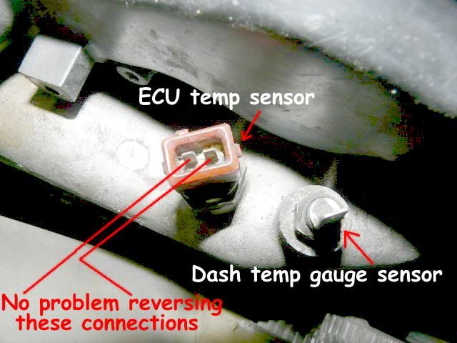

Cleaned those pics for you and labled the first one, does that help?
Jeff TT
Jeff TT
:clap:Thanks Jeff that's all i needed to know:thumbup:
