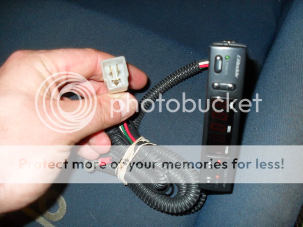

I want to fit this spare Greddy turbo timer that I picked up a while back but just wanted to clarify how to go about fitting it
It was advertised with a 300zx loom already attached so I assume that it should just be 'plug and play'
from the pic below, can anybody tell me if this is actually a 300zx loom?
if so am I right in saying that it should fit near the ignition?
cheers fellas

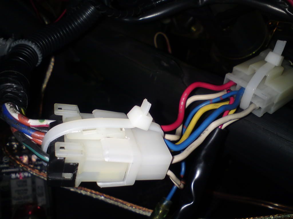

After reading much I have now fit my GReddy Auto Turbo Timer.
I have
Red to White/Red - this is 12v permanent.
Yellow to Black/White
Blue to Blue/White
Some notes on the pic below, the black shiny sheathed wires that head off the pic at the bottom, you may notice one of the 3 wires within this is cream, you cannot see it but it is in with the thick cream one furthest right into the connector block on the pic, this just heads off and goes to a blank bullet. So then I have a blue wire that travels outside of this shiny sheath, you can see just on the pic that it does come apart as there is an inline sheathed connector, then there is red and yellow and these three go into what is called the power harness (FYI on mine the yellow wire connects at the multi plug and becomes a green wire) these 3 ultimately go into the turbo timer head unit.
The pic in the previous thread, yes those pins need to go into a turbo timer harness or you can just splice straight in, of course the black wire needs a good grounding point. You have red, green and white I notice, along with the black, so based on my colours of my wires, an educated guess would be, red connects to red, green connects to yellow and the white connects to blue.
Hope you understand all that!!!
My harness was not plug and play for some reason, I had to take out all the locking spades/pins and swop them over, making the correct male/female connector on each end to fit, that's why you see a cable tie on both, don't want it coming apart :glare:
I am yet to connect the speed sensor wire into the ECU one, I believe this to be A9 on the diagram, so if someone could shed some light on that and the work involved I would be grateful, thank you.
Now finally on to what happens, I set the timer at 30 secs say, take keys out, get out, close door, I then zap it and it central locks (usually here it beeps as well and arms the alarm), finally engine stops and the separate immobiliser activates immediately as normal, the car is still locked which is fine, at this point I have to zap again and it beeps at me and the alarm arms, doors are still locked, I then go inside forget about it.
However, the alarm will not arm until the engine as stopped running, so in theory I will have to loiter, defeats the object really :sad: is this down to a wire that needs connecting to the alarm system, perhaps the blank bullet from the turbo timer harness? Or the inline bullet on the blue wire, might have to go somewhere and then come back? ****UPDATE***********SEE MY POST 13 BELOW*********
Of course I want it to arm and lock when running/counting down, it takes 15 secs or so for the alarm to fully set anyway once it as beeped at me?
******UPDATE*****THIS AS BEEN SORTED SEE POST 14 WHICH EXPLAINS HOW*********
Any help greatly appreciated and hope my pic and description helps into the future.

A further update to post 10, a common problem and something I have viewed in many threads/posts is that the alarm will not arm as the engine is running because the turbo timer as cut in and is counting down, so we need to trick the alarm into thinking the engine as been turned off and so we can just zap and this locks the doors and activates the alarm.
This is a helpful post on the Oz site
http://www.aus300zx.com/forum/showthread.php?t=265802
You will notice a diode as been used in post 2 and this is what I have done and here is a pic of my turbo timer harness showing where the diode needs to go.....it is mentioned in post 4 that a diode had failed, I have liaised with Groover and he tells me a small diode should be ok as the voltage and amps are low but you can buy a larger one if you so wish.
Self explainatory really, cut the black sheath back a bit and sever the yellow (on mine, yours may different a colour) wire and put it inline, the stripe on the diode needs to go nearest the turbo timer connector or nearest the right on the pic, you can just see it.
When this harness is connected up, this yellow wire goes to the black with white stripe on the car ignition loom connectors.
The blue wire to the right is the one I talk about in post 13 and this connects and livens up the radio and lights. The blue wire and the white wire are left like this unused.
Hope that helps :wink:
