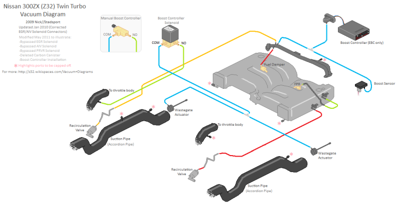

This is a good diagram
it shows the pipe going to the little pipe under the hard pipe but only on one side. so do i just blank off the other one??
Is there anything i need to blank off when doing the above. like from the stock solinoid to the waste gate??

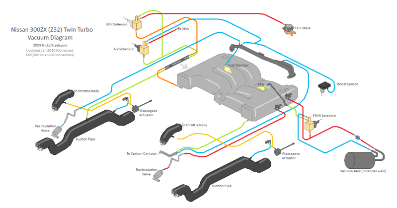

This is the stock set up i have at the min. can anyone please photoshop on this what i need to do and what needs to be blanked off or what ever :wacko:
You can just cap it off (which is what that pic is recommending), or you can T them together.
Do your deletes mate and get rid of all the bulky pipe work, ive just done that and i can tell you, its a lot simpler to sort out than trying to re tube all that lot lol
