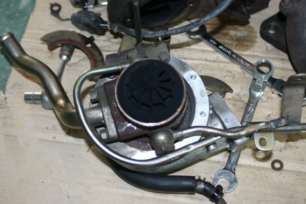

following this guide http://www.renault5turbo.free.fr/Stock%20FORUM/Documentation/T25_turbo_instruction.pdf
but ran into a slight problem, it just says "remove the bolds and the holding plates"
doesnt mention anything about the fact the bolts hit the bloody oil housing in the center of the turbo. tried pulling it off but no joy with the bolts half out.

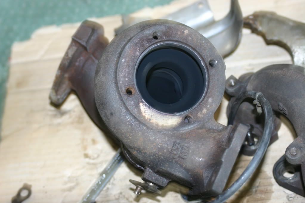

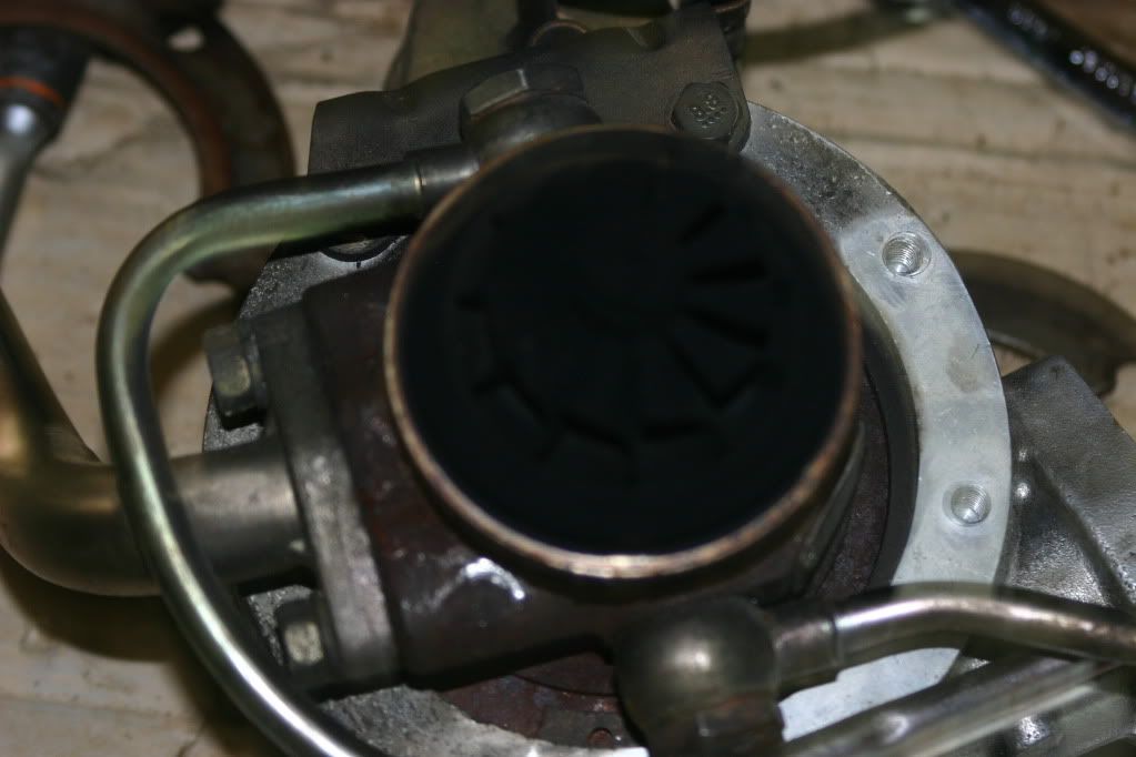

woot, its off lol
bit sooty but no sign of oil, slight play in the shaft. might even have a laugh and refurb them.
