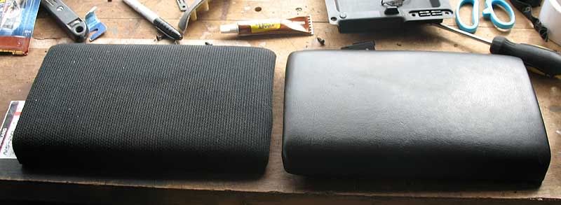

After disassembling we find all we need to do is a bit of hacksaw action and we can fit the LWB top section onto the SWB base with very little problem :)

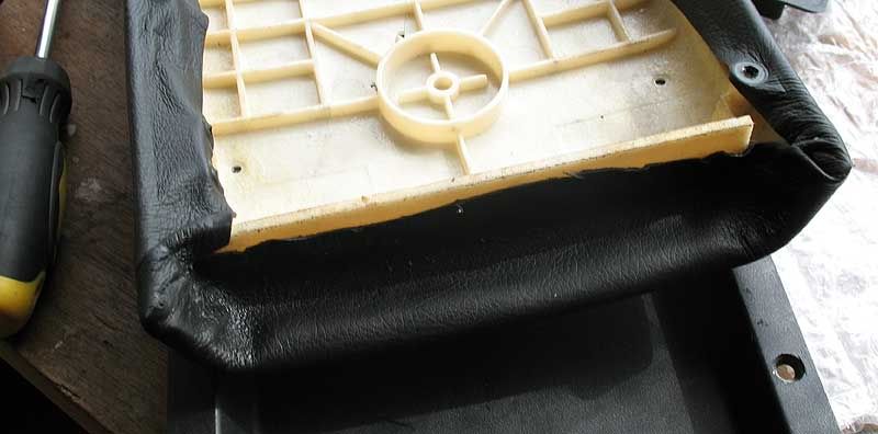

Peel back the leather and mark it up:

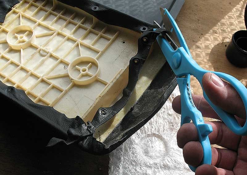

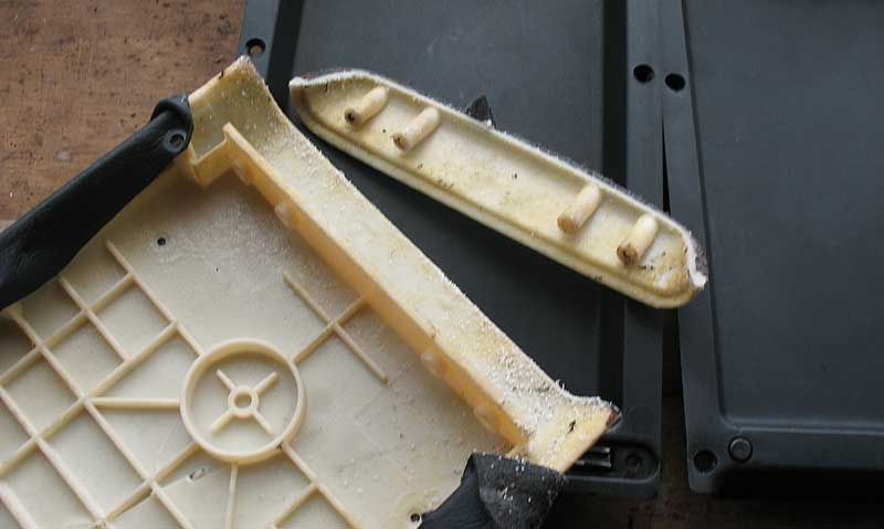

Cut it off:
Trim the leather:

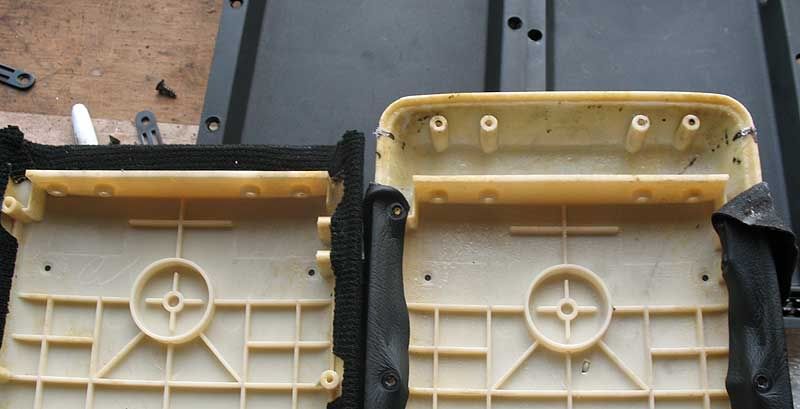

Tuck it all back in with a bit of adhesive, and punch through the hinge screw holes (as they are virgin holes, it helps to screw in the ... err ... screw to tap out the plastic while its easy access ;)):

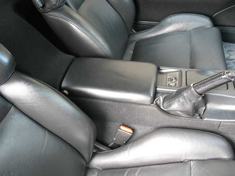

All done ready for re-fitting (looking better than the cloth even now!):
And in place:
