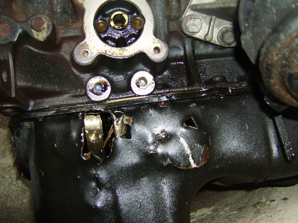

i remember saying the same thing when i first got my silver 300zx, "sounds like top end knock" then this happened

just like my engine knock knock bang bang .. followed by dead engine and oil & engine bits all over the road
certainly sounds like ends mate if it wasnt like this befor it was stood up you could give it an oil and filter change but sounds like damage has been done to be honest
