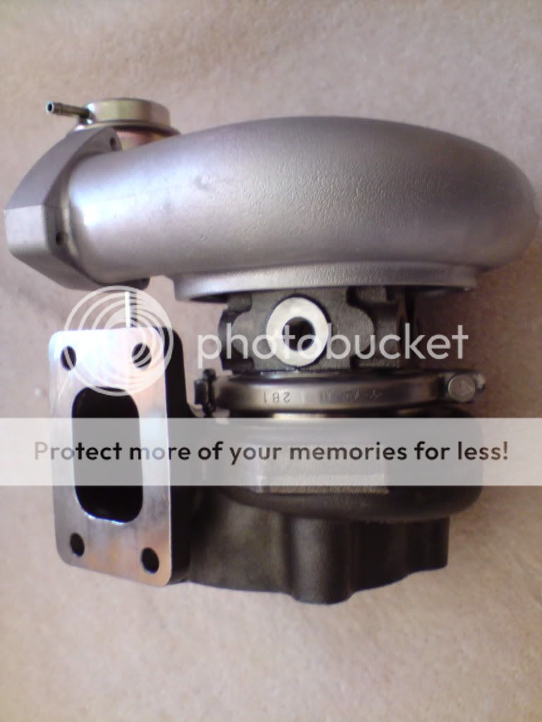

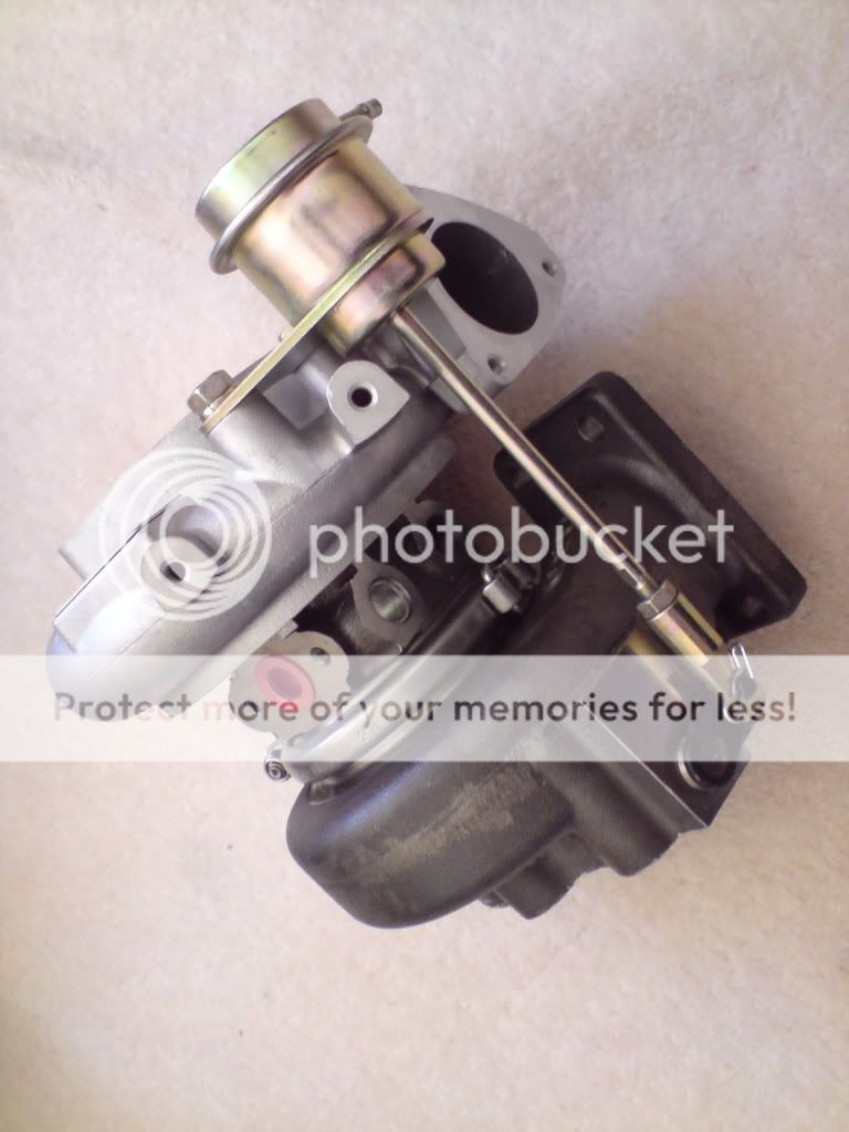

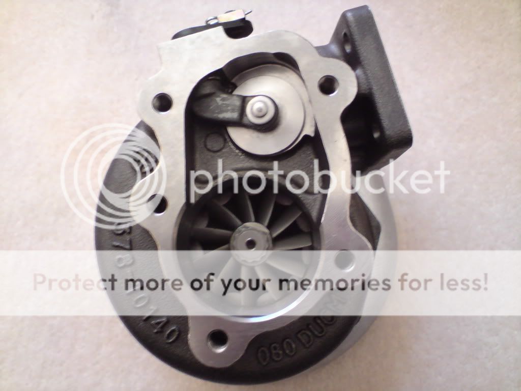

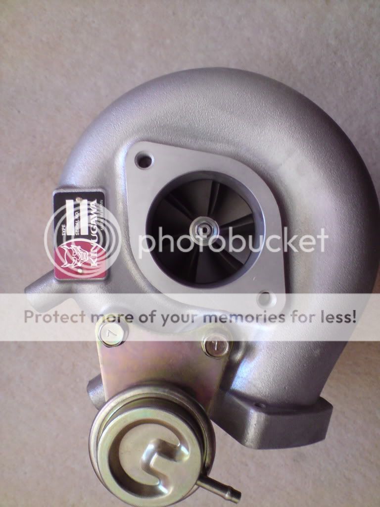

As some of you know I used to run Kinuagwa turbos off ebay on my s14a (hence my name and not a plug) which I found to be a good alternative to Garretts as thier price level was usually 2/3's of the equivalent model. But I do take in to account the ease of a turbo change on a sr20det against that of the vg30dett and this would influence my decision when choosing uprated turbo's on a z32. I now run a Greddy T67 on my s14a but this was due to a bargain off ebay from a smashed up MR2 turbo :hammer: otherwise I would have upgraded to Kinugawa's own T67.
This was my old TD06SL20G with a t25 flange. Cost me £600 and was good for 1.5 bar old day long! As you can see the build quality is very good and it felt and drove like a quality product.
As i mentioned earlier check out sxoc for T28's or T28R's as they come up quite often as 200sx owners usually upgrade again to 2871r's/3071r's etc.
Rob, sorry to hijack your thread with such a long post but I hope this post is both helpful and informative in you choosing the correct turbo set up in the future.
