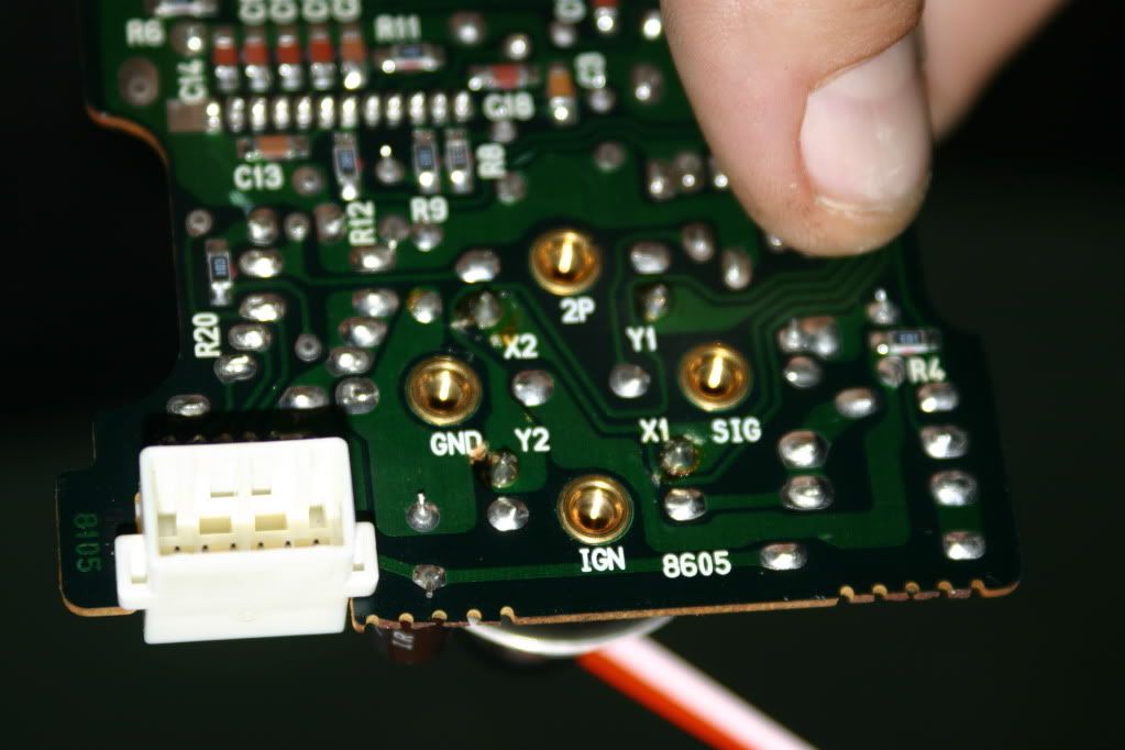

Right, ive taken my old jap clocks apart, and also removed the needle to find out what problem your going to have.
Now with the unit removed from the dash cluster
The only real problem is, the needle housing is enclosed, so not much use there.
Its soldered on to the PCB in 4 places and also held in place by the 4 copper screw mounts
so replacing the unit is going to be a pain in the ass by the looks of that, unless you get a new needle PCB with the needle already in place.

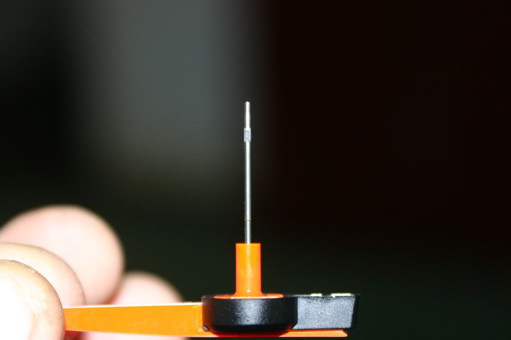

When the needle is removed you can clearly see the splines in the needle shaft
This connects inside the unit. problem being is, once removed it is free of the housing that in closes the splines onto the plastic holder at the bottom.
Now my perfectly good rev counter needle (didn't touch) if it works the same as the speed needle is quite floppy with very little resistance.
Only problem I've found so far, with placing the needle back in, is that there now seems to be movement in the vertical plane of the needle, so even when bringing the needle back out slightly it eventually works its way back into the unit thus stopping it moving.
My only thought on repair would be to either put a small paper washer inbetween the unit housing and the needle and hope it doesnt interfere with the workings. or strip the unit down completely and see if you can get to the rear of the needle to glue it back into place, I wouldn't recommend putting glue on the splines and pushing the needle back through the hole as it would just get stuck half way down before you even got the needle seated right, even then im sure you would end up gluing the needle mech lower down thus ruining the speed o completely,
