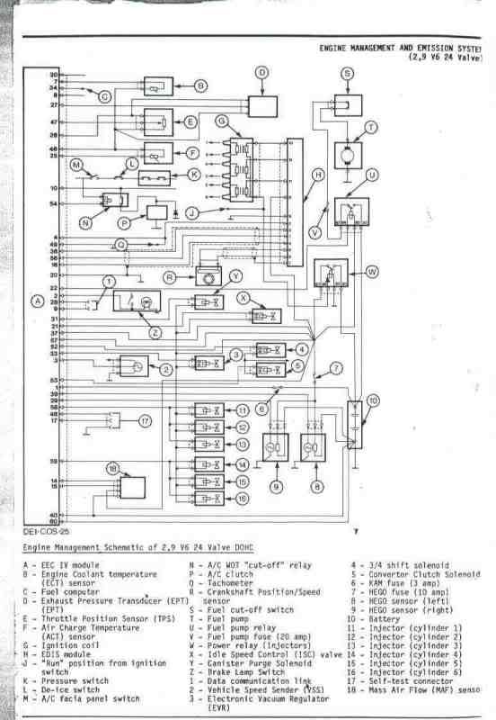

Mate of mine is putting a 24v Cosworth into his old Capri and was wondering where he can get any advice/diagrams for figuring out the ECU.
He has the full wiring harness and would like a few pointers.

Spoke to Daz , he got his wiring diagram off the Transit van forum , he thinks he,s still got a copy on his computer but he can,t e-mail it or post it on here until maybe the weekend when he might be back online bud . HTH

Here you go mate,sorry busy decorating!!!:ph34r:
Should find it easy to do.
