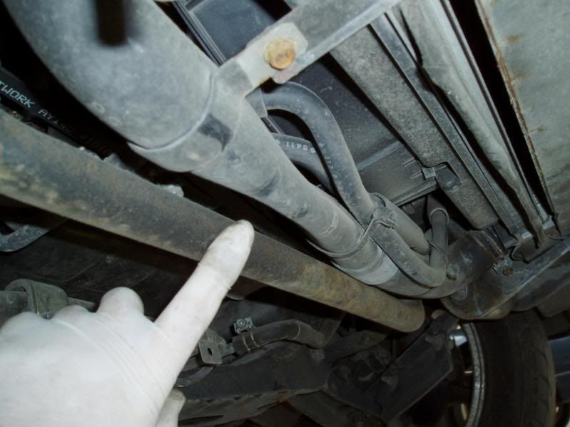

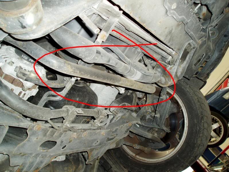

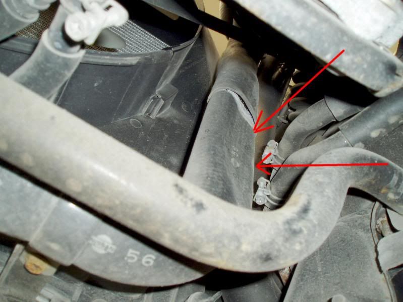

Last year I posted some pics of how the lower rad hose can fail internally and gets sucked in, again an example of this is clear to see, I know this is not a new problem but well worth checking, best to check 30 mins or so after a run to see if this is effecting your zed, we all know how serious it can be if cooling issues are left unchecked.

That's not, I need to change miobne as been putting it off! I have a nice silicone one :yes:
