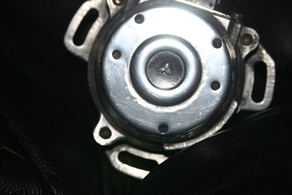

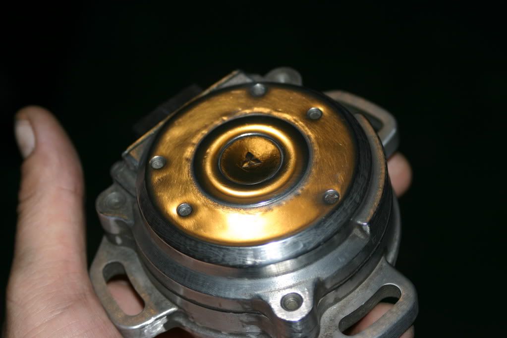

Not very good pictures to be honest, cant seem to show the shine it actually has, but after 3 days of constant sanding with finer and finer grade sand paper on my CAS, plus a rotory tool to get started. ive ended up with this so far.
Still a long way off what im aiming to achive, but its a start
I cant seem to get to the inner bit properly so its looking all pitted in the photos still.

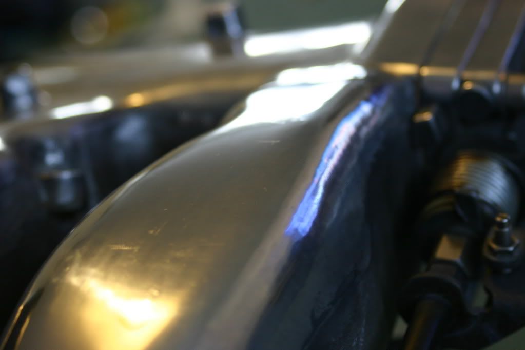

Lower two are of my plenum
You will need the throttle bodies off mate, to get to the front legs of the plenum.
Long process aint it lol
plenum was half polished anyway, its the one of the blue zed, im concentrating more on the CAS at the moment, going to start afresh on one of the other plenums I've got, this half shiny one is going back on the engine, until I've finished the other one to a better standard.

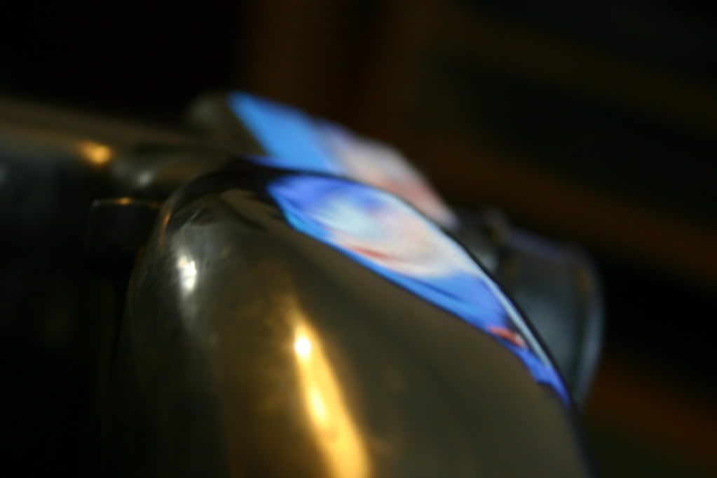

The photos don't show up just how shiny it is. i was trying to get the camera to focus on the reflection of the TV in it. but the shine just warped the image instead lol
Cant believe you've got a decent canon SLR camera yet you took those pics with a disposable :lol:

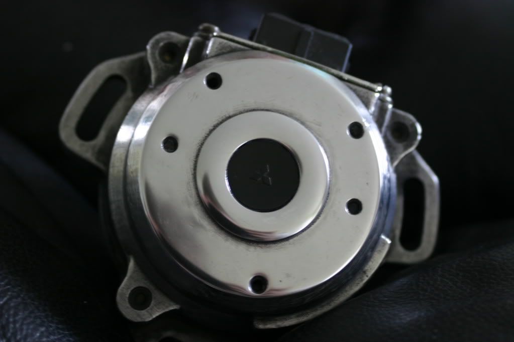

is that better? still cant seem to get a good picture though? second one does show the top of my head and my lens hood in the inner polished ring, still have to do the rest of it. also think i could get it a lot better tbh, but not bad so far for a first CAS polishing attempt me thinks
you will probally struggle, to get those deeper scratches out now. yopu need to go back a few steps unfortunatly, get a scotch bright pad for and angle grinder this should take out those lighht scratches. then its back to sizle and compound. you can use a soft mop and some autosol for the final super mirror finish. be carefull though because it will go everywhere. its all to do with direction aswel, i can see how you have worked round the cas you should cut the whole thing at 45 degress then reverse the 45 cutting across the grain. dont add another direction though and for the final mopping just do one direction. :)
well, it will do for now, i have another one thats on the old engine, so will be polishing that up, im using this one as a test bed to see if i can actually polish something. so doesnt have to be perfect. ill attempt that on the one on the old engine.
In fairness though, the camera is picking up a lot more than i can see.
yeh it will do with teh flash on, hope you didnt take that all as critisisum, was only trying to be productive. make sure you laqour things when your happy with them else you will be repeating the process after 12 months.
