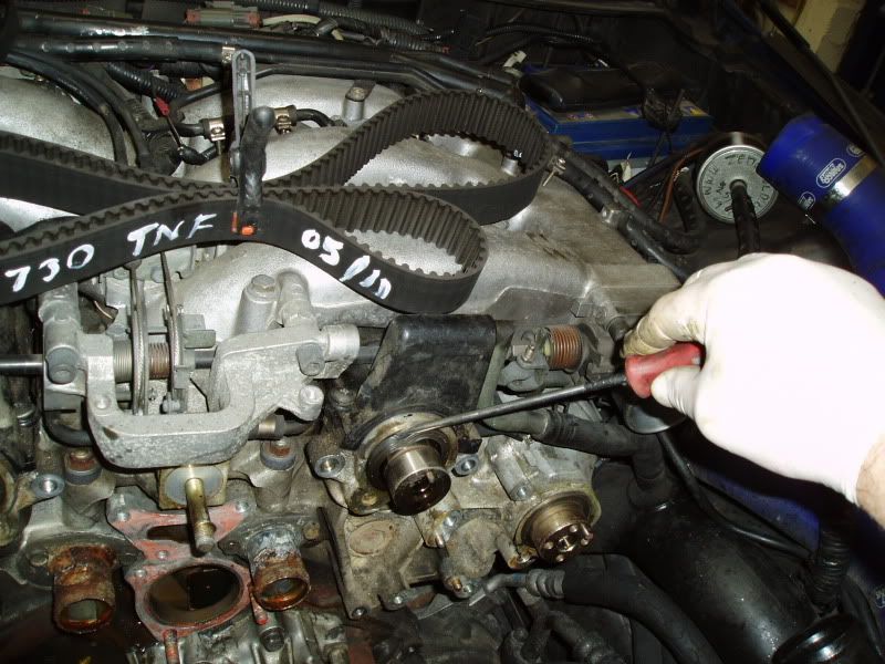

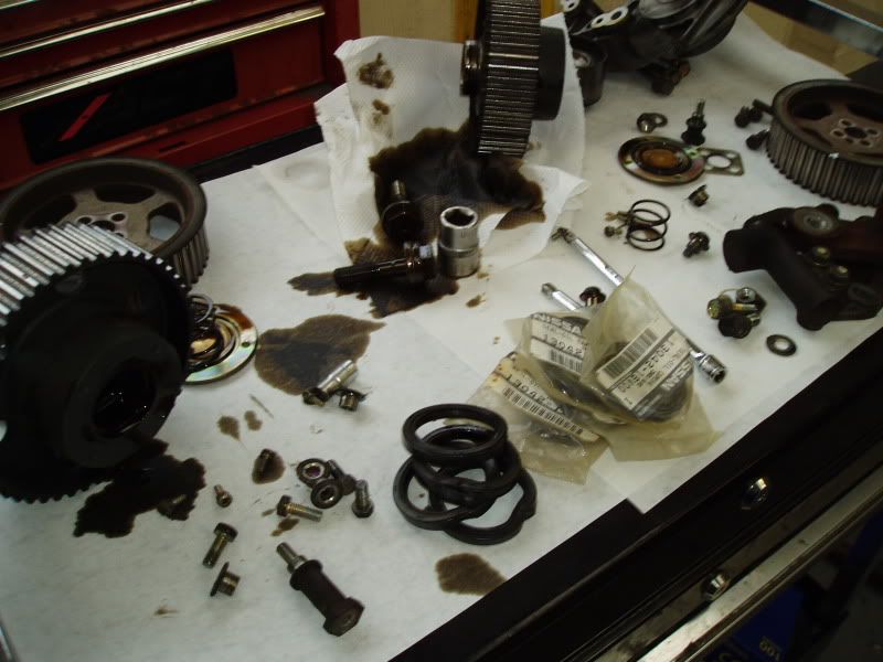

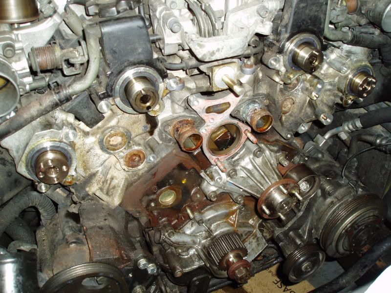

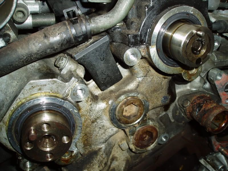

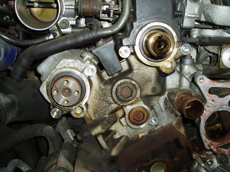

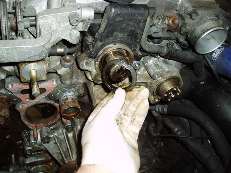

The cam end seals are one of those jobs where the disassembly is more than the actual job. The pictures below show how far you need to go in, good thing is you do not need any special tools with maybe the exception of the crank pulley puller.
