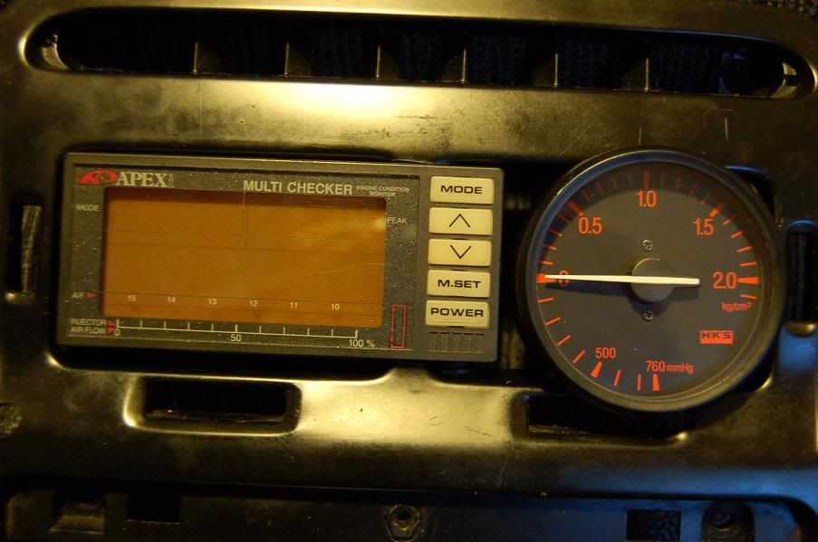

This isn't a 'do you like my centre console' thread. I know you wont, but its the best way I can get everything fitted in. :tt2:
I'm after some ideas of how to mount these bits in the console - Can I use body filler to fill the old roller adjuster holes for the vents (obviously need painting up afterwards?) but then I'll have the gaps around the gauge and controller. Or should I get some carbon fibre sheet/perspex etc and cut perfect size holes in for them and attach this to the console?
Just after some advice as I've never attacked something like this before LOL :scared: so thanks for any input.
Use Fibreglass filler (p40) to fill holes, then smooth with Bodyfiller (P38)
TBH Baz,that's awkward to fill,I would make a panel to mount the guages in and flush that to the console.......
Thanks for the input guys, I was thinking making a custom panel and attaching this would be the best solution. Watch this space! :thumbup1:

Ive done a similar jap using P40 and then a bit of filler. After using plastic primer and black spray it looked great.
