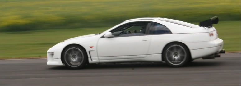

Personally, while it can be drifted and its easy to get the back out and held around the local roundabout I think it makes a better track car. The Z has an excellent race history, and handles quite well, unlike many of the popular drift cars. With plenty of Improvement potential if you like to play with cars and have the pennies.

Incredible track build Z's all of which regularly show up much more expensive race prepared cars on track.
Within the UK Bobgenie, Jaffa, Silverbullet and j1mmytt have impressive Track biased Z's too.
