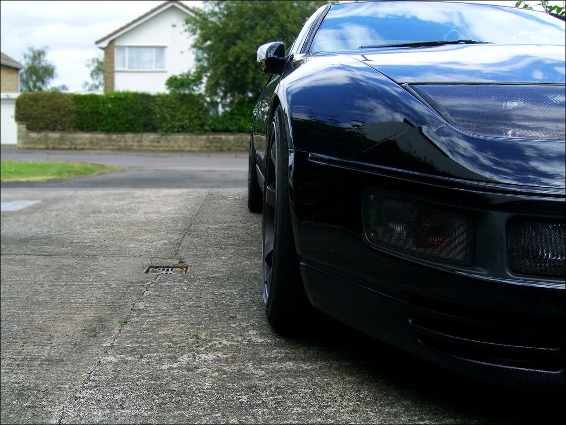

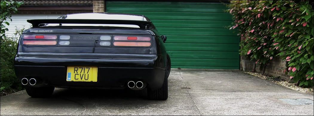

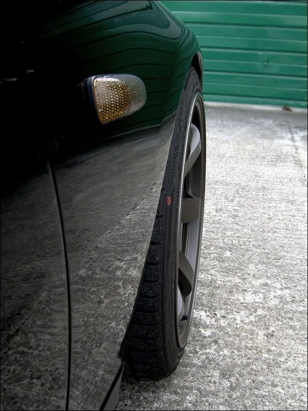

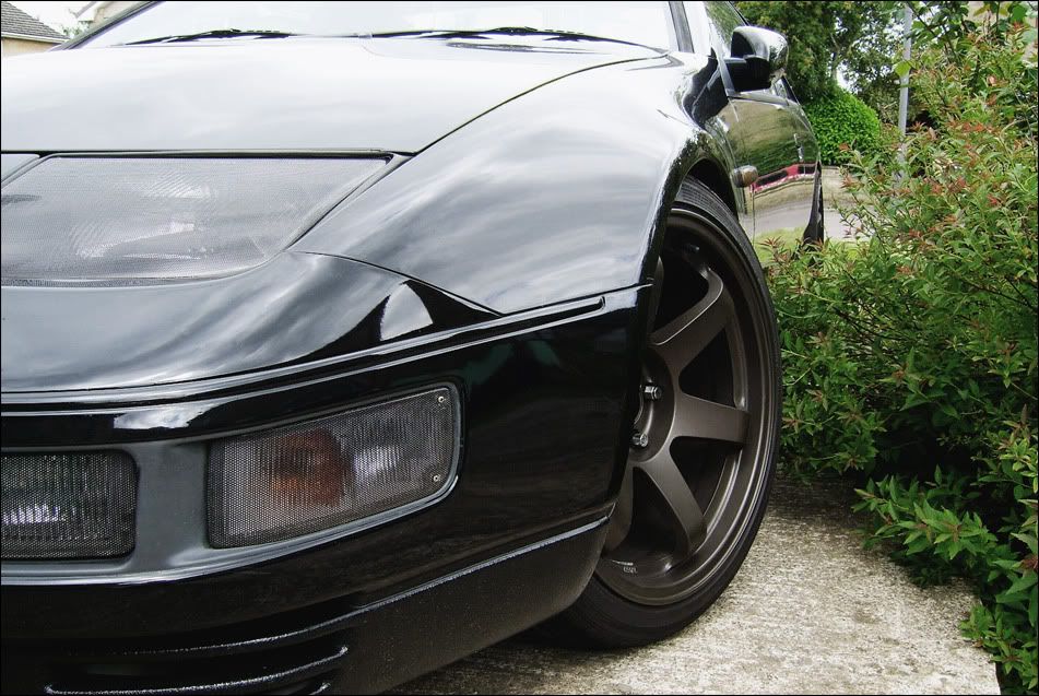

Here we go, remembered to go outside and take some pictures today.
The wheels are 18" Rota Grid, 9.5" wide with an offset of +20 front and rear.
Front tyres are Falken 452 in 255/35/18 and the Rear are 265/35/18.
Sitting on MeisterR coilovers.
There is no rubbing on the front arch liners lock to lock.
Last picture shows the standard rear arms adjusted to their maximum negative camber.
As I mentioned in a previous post, the tyres would rub the lips on the inside of the rear arches before I rolled them up inside. Nothing about the front has had any modfication or adjustment.

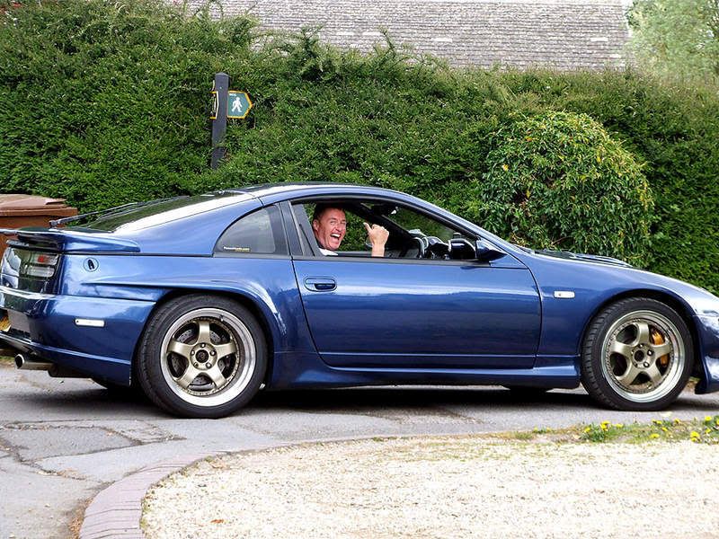

Can't remember who this belongs to, but it looks like 17's to me.
