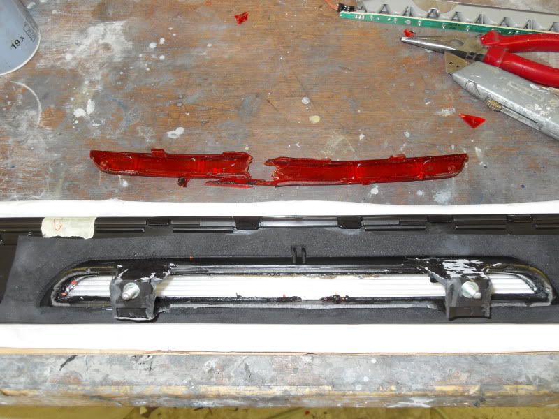

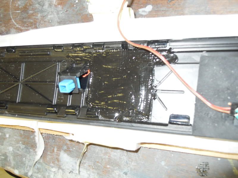

I bought a new trim and took a deep breath and started cutting it about, after doing a trial on an old broken trim to see if it would work !
http://www.300zx.co.uk/forums/showthread.php?t=148783

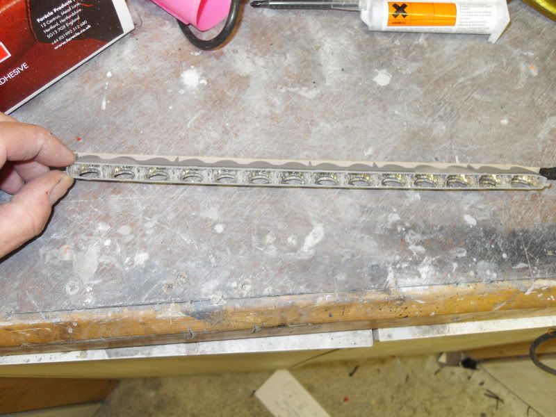

Found another light which was longer than the one i did the trial with so it would fit better , removed the outer shell and trimmed it down to size .

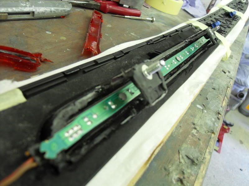

Cut out most of the original one and carefully removed the red lens inside

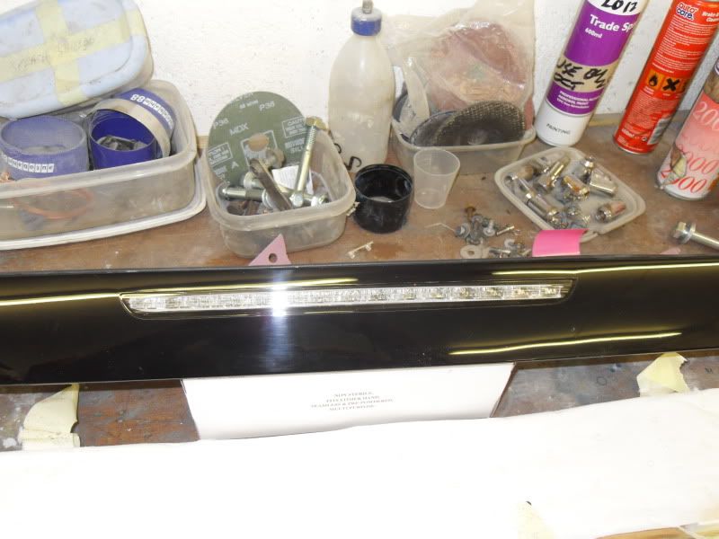

A bit of trimming and in it went

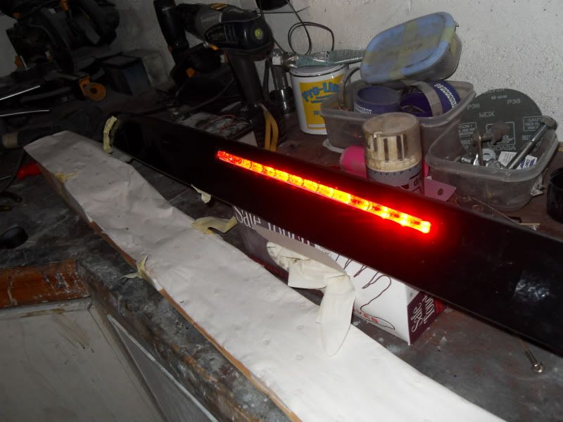

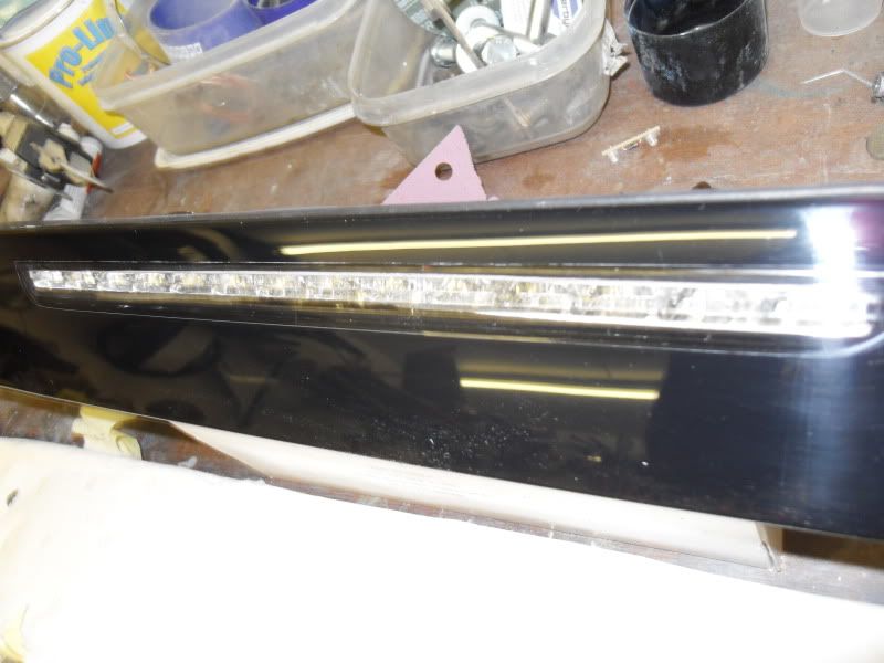

Looks alot more modern when lit and when it,s not it,s now clear instead of having the red lens showing through :hyper:

BTW i know these are really brittle in two areas that have a gap in the backing , a pi55 poor design fault ! but to stop me sweating so much doing this i used some bumper repair glue and reinforcing mesh to strengthen it .
My last one broke at one of these gaps so hopefully shouldn,t happen again:thumbup:
