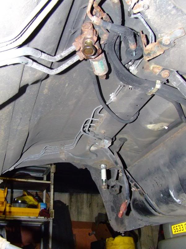

please can someone tell me how to remove the large banjo thingy that the pipes from the rack go to.
iv ripped all the pipes out right up to under the boot floor all thats left is the pipes that go to the rack and the pipes that go under the car but there fixed up on banjos somehow under the boot floor, iv looked for bolts to unbolt the unit from inside the boot but cant find anything and iv looked for bolts bolting it up but still cant see any, any one know?

It bolts from under the car,but are a pita!-you could leave it on no harm,get it off on a ramp,so much easier!
Are you on about the little motor up near the petrol tank? I took mine off yesterday and its bolted from the underneth with 3 10mm bolts, nice and easy :)
bolts from under the car i just cant see it and its doing my head in, i want it off so i know everything hicas related is in the bin, where are the bolts mate

No they just take off the banjos off the motor, there are 3 10mm bolts holding up the motor. should be really easy to see :confused1:
i think you mean the solonoid under the bonnet mate, im talking about under the boot floor at the last point where the pipes go to the rack. there is a clump of banjo and metal and i wana unbolt it all and drop it down and cut it out the car but i cant see how to get it off,
doing me ed in iv been on it all day
Do you mean this:
Also, i take it you've removed the HICAS ECU from the passenger footwell?
yes that bloomin thing is the cause of my stress, how do i get it off please.
I cant remember off the top of my head but im going upto my unit tomorrow so i'll have a look see, if nobody has replied before then.
