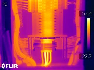

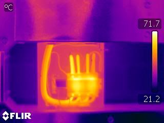

this is what im doing the now at work going round primark stores taking thermal pics of the internals on the electric boards can be quite boring but you would be surprised at some of the reading you get. if any of it is between 60 and 80 degrees its dangerous and gets phoned in straight away and if its over 80 there is a high risk of it melting or going on fire

here is a few examples
BOTTOM OF ONE OF THE DISTRIBUTION BOARDS
THE DISPLAY LIGHTING CONTACTOR
