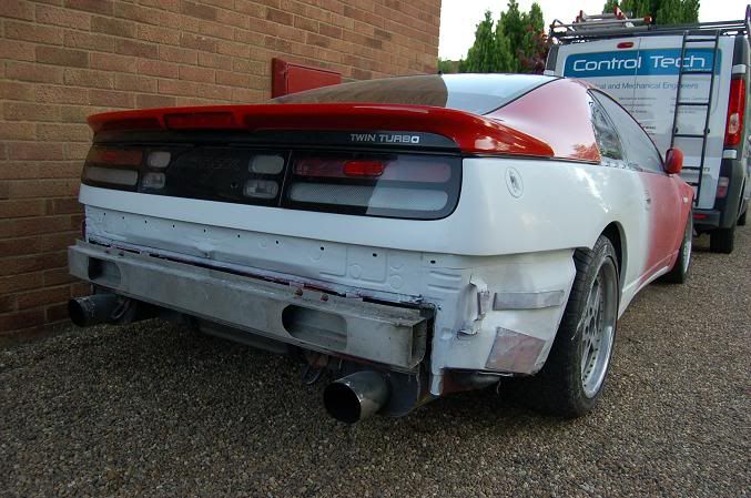

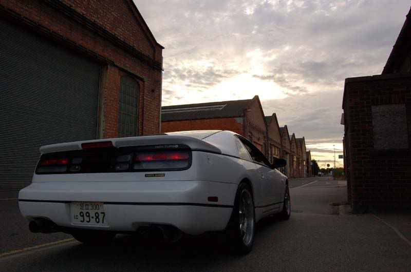

I just wanted to give my car a fresh look rather than a long term paint job, so I didn't prime or lacquer it. Just wet n dry'd the whole paintwork and sprayed away. Once enough paint was on I flatted it with 1200/1500 wet n dry, then G3'd the whole lot until there was a smooth uniform finish. Its really easy paint to use and gives great coverage and a good finish. With lacquer on top it would be brilliant. :tt1:
GLOSS I SAID THAT ALREADY :lol:
Gloss or matt?
Any decent pictures of your car mate?
only photo shopped ones!:lol::lol:
can't remember exactly how many cans.... they are 500ml and I think I used about 20-25 (£35-£40ish total iirc) cheap respray FTW. :tt2:
