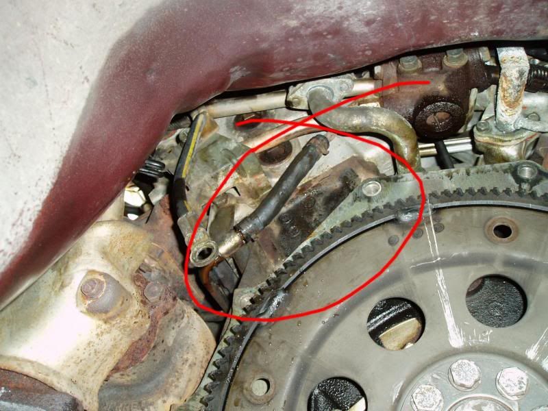

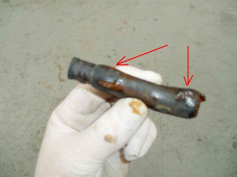

Whilst untaking an autobox change Jamie spotted the rubber turbo water pipe that links two metal pipes on the rear if the engine, a common failure and was just about to fail big time, lucky for this engine its was spotted beforehand.
Jeff TT
Nasty pipe removed

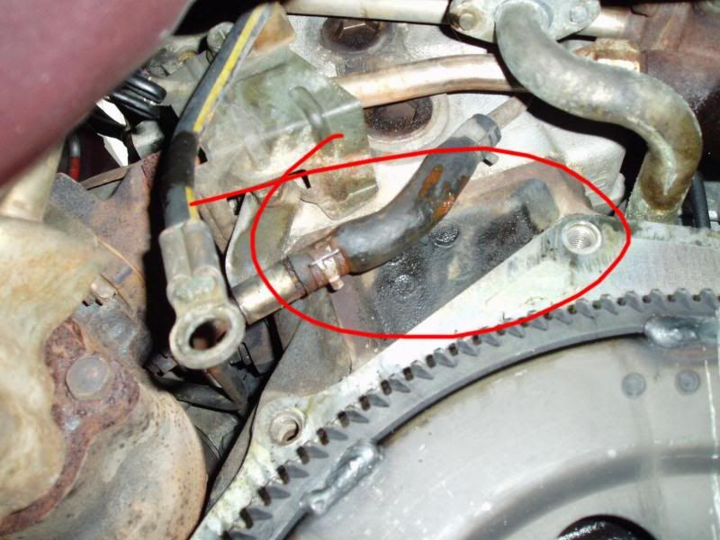

New pipe fitted
Just done that very hose, had gone when I bought the car so did the complete bypass. What a tw@t doing it in situ!!! Seriously missing some skin on my hands!
Argh bad luck!! is a git normally, with the box out is a breeze in the park.
Jeff
is this part on all tubby Z's Jeff or just before a certian year?
Yep all TT`s have them.
