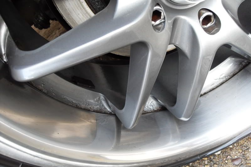

I,ve just had a set done , they bead blasted them and powder coated them apparently you can make a right mess of them with sand blasting as it can remove too much of the alloy , bead blasting is alot kinder on alloy !
These were in a bit of a state , they originally had stainless steel lip trims on and it,s these that caused alot of the corrosion so i got the grinder on them and removed them .
With the trims on
Without , you can see how much corrosion was under them :crying:
And finished , i like them without the trims , not that they can be replaced anyway .
