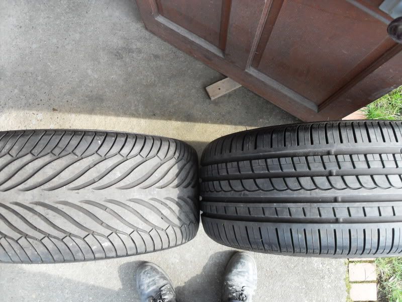

Can anyone see a problem in doing this , i know they should be 35 profile but i,ve got a perfect pair of Potenzas that are like new and it seems a shame not to use them .
On the left is a 255/35/18 and on the right is 245/40/18 , what,s 10mm between friends :blushing:
Not much in it
Speedo will be out as the rolling radius will have changed.
I know but if you think of the difference between a new tyre with 8mm and a worn one with 2mm , there,s a 12mm difference in height just on wear alone that,s why i was thinking a 10mm difference in standard height can,t make that much of a difference with the speedo :confused::confused:

yeah fine - i dont see a problem at all as long as you use a pair. just be aware the rolling circumfrence will be a bit different.
The usual is 235/40/18 front and 265/35/18 rear, so somewhere between there will be fine!

Your speed will be 1.93 mph higher at 70 mph.
Paul
Cheers bud , nothing to really worry about then .

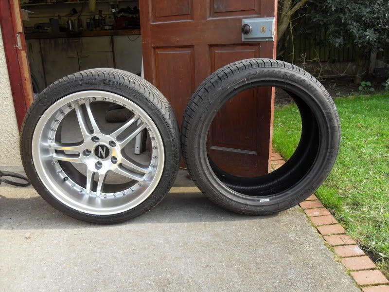

Cheers bud , they,re the Inovit tuning ones off fleabay , now i,ve got a set of tyres for the white ones as well , so i can swap and change as the mood takes me :thumbup: lol
