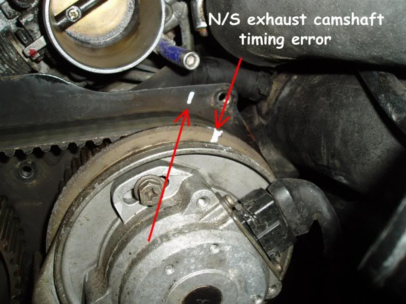

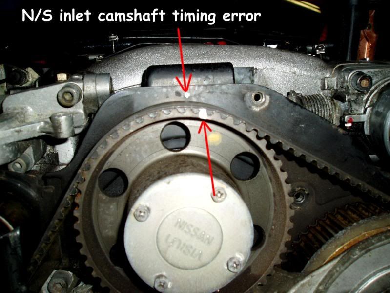

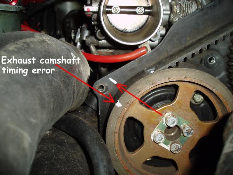

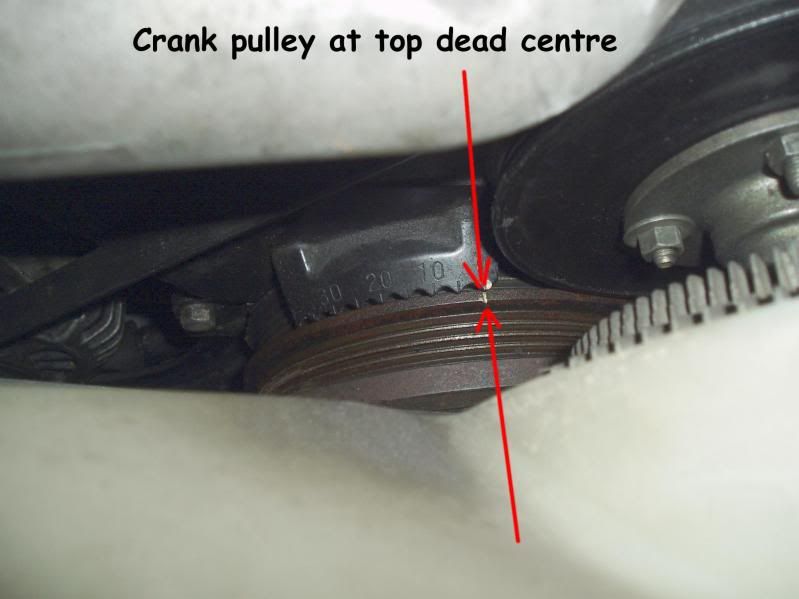

Hi Jim, ok more revealed with the engine running issue, seems the cambelt has skipped on three camshafts, only the o/s inlet one is correct!
The worst one been the os exhaust been two teeth retarded, which explains the odd fuel firing down the exhaust on that side, the other two camshaft been one tooth advanced!.

Problem with cam timing errors is it messes with the 4 stroke cycle which can cause firing down the exhaust as the exhaust vales are not closed completely, or open too soon which causes poor gas compression.
Generally though if a single camshaft timing is incorrect it should effect each cylinder on that bank the same but in practise we have found this is not always the case, most likely due to different wear rates on the cam lobs and or the valve seat differences, misfires are not the same though.
