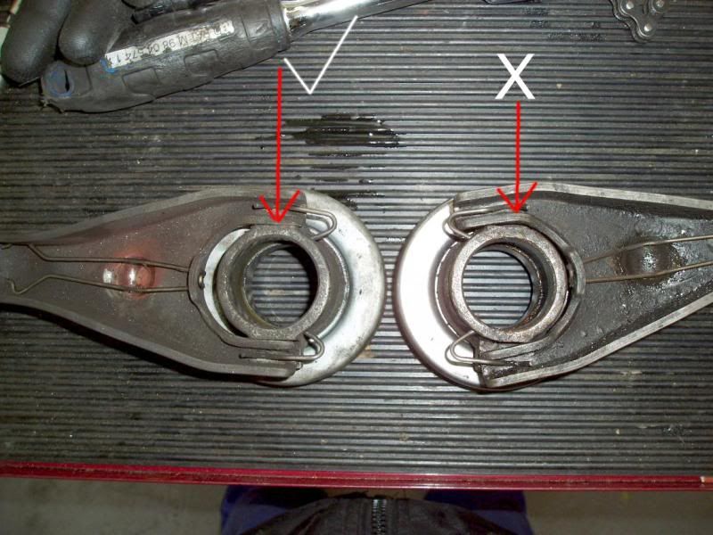

thought i'd update on how the job went, even though it was weeks ago....
this is what the problem was
IMAG0015-Copy.jpg[/img]
IMAG0013-Copy.jpg[/img]
IMAG0014-Copy.jpg[/img]

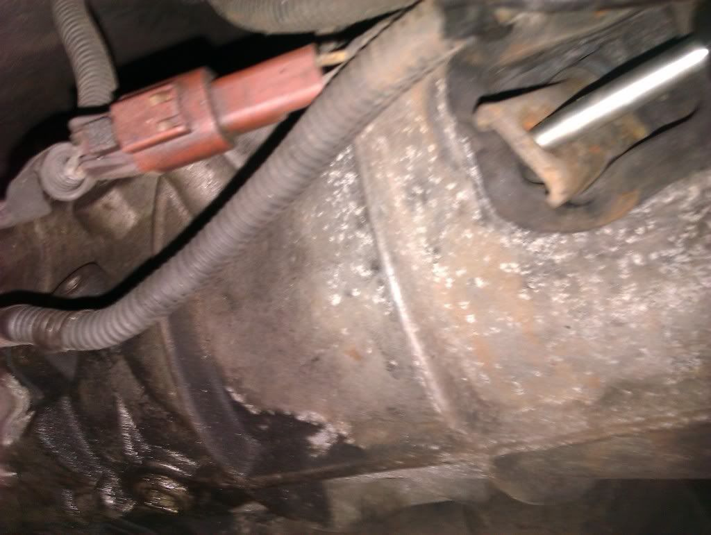

after toiling for a while using a lift designed for some sort of tank (with a considerable larger ground clearence than my zed) we finaly got the box out to find this....
IMAG0016-Copy.jpg[/img]
looks like the bearing carrier was ok though...
IMAG0018.jpg[/img]
and so was the pivot ball
IMAG0020.jpg[/img]
just to be on the safe side, replaced the ball, bearing carrier, obviously a new fork and the relevant springs and put it all back together
