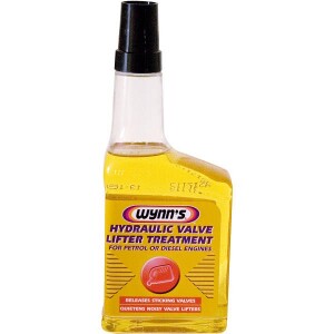

Pour the lifter treatment in the oil filler, really easy. If its not lifters, it could be a variable valve timing spring, they cause a ticking, rattling sound. Mine has been doing this for months, its not going to go bang, just annoying lol.
If you are in Stoke (on Trent?) get down to Jeff's near Birmingham, probably need to be monday now, unless youre heading home.
Your pod should be waiting for you at home, by the way :wink:
Can be purchased from any major autocar parts shop (Halfords)

yes the oil change is an easy task filter is not in to ackward of a position but a garage would prob only charge you a mere £20.00/25.00 for an oil change get the nissan filter or a wix one and you will have a copper washer to that lurks behind the sump nut these are only supposed to be re-used a few times
the lifter treatment can be sourced from e bay or the like and should show from a search for lifter treatment or hydraulic liffter treatment
