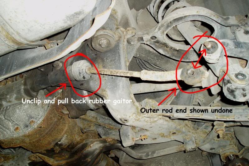

The outer rod end has a spilt pin that needs removing, then undo the 17 mm securing nut, a ball splitter helps with parting the rod end from the outer bush.

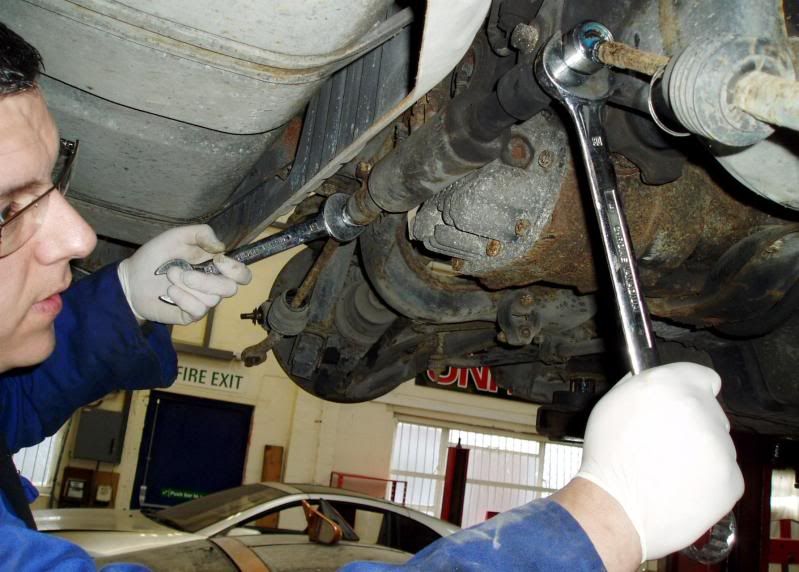

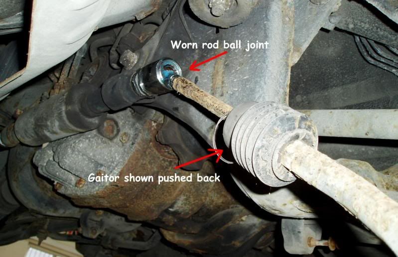

The gaiters are held in place by wire clips, cut this with a pair of side cutters taking care to not catch the rubber gaiter, once the clip is removed pull the gaiter clear of the ball joint.

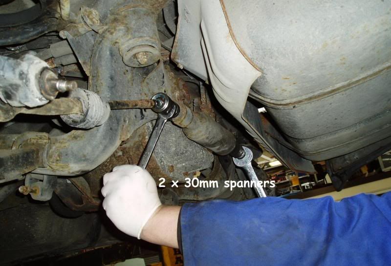

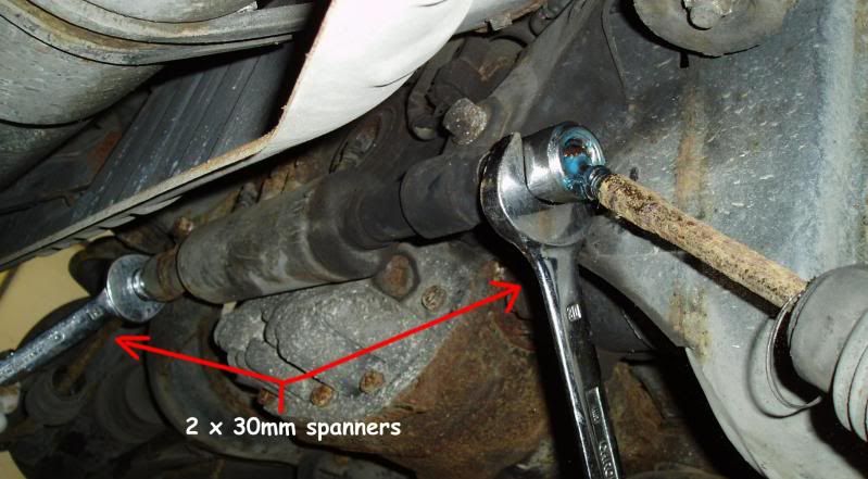

Whether you are changing one or both arms you need to do undo both gaiters, then with two 30 mm spanners one on each of the inner ball joint nut flats undo them against each other. Only one will come undone, the other needs to be undone a slightly different way.

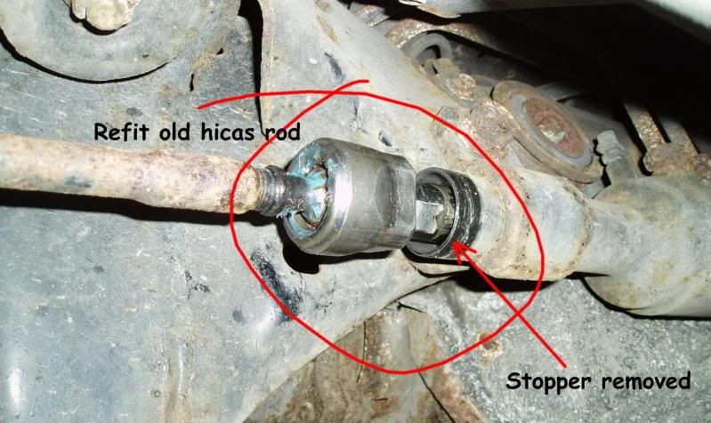

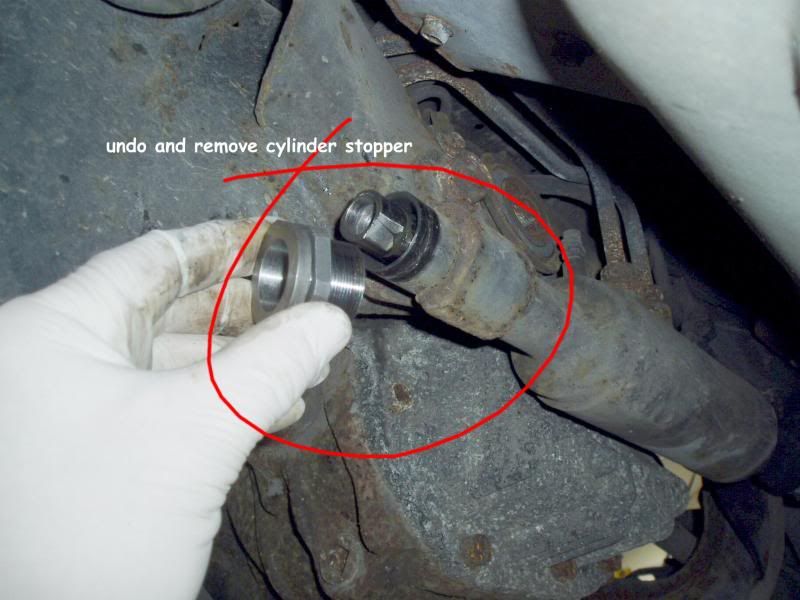

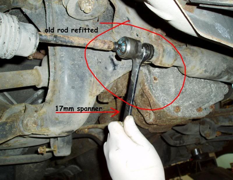

Now undo the stopper lock ring and adapter, this when removed gives access to a 17 mm flat on the steering rack ram so it can be held in place whilst the remaining arm can be undone.
One real important tip is when using the ram flat the old arm should be reinserted first as the ram is hollow and will deform if there is no arm fitted, this will wreck the ram and the new hicas arm will not fit in the thread and hence a new rack will be needed.

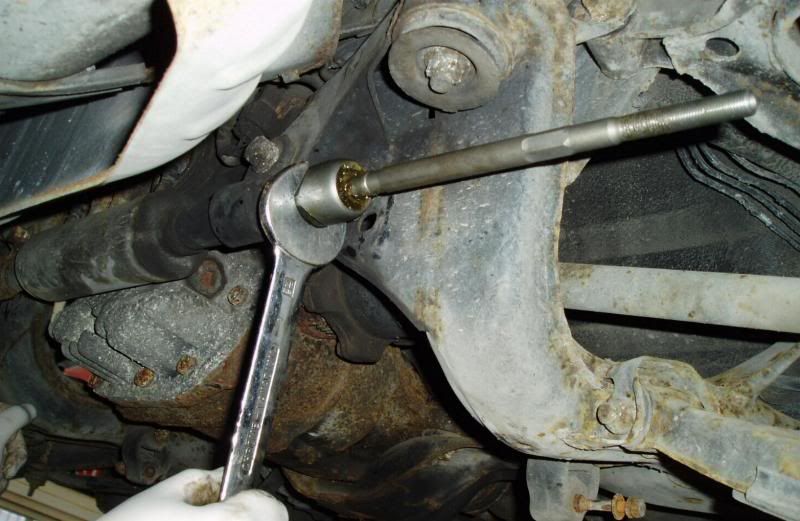

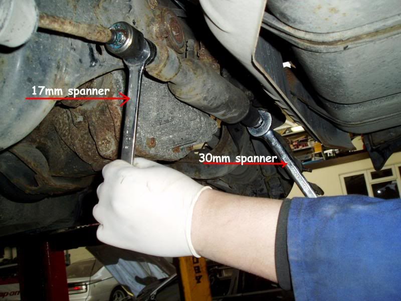

Now with a 30 mm spanner and a 17 mm spanner the other arm can be remove.

The effects of worn arms can range from slight unsettled feeling to dangerous, by far the most common failure and the most beneficial to replace, most drivers will be pleased by the change in how their their zed feels after worn arms are replaced, some MOT stations miss them not understanding the hicas system so just because your zed has an MOT does not mean your hicas arms are good.
Worth checking, with the wheels off the floor and hand brake off check by placing your hands at the quarter to three position and pulling and pushing to feel for wear, its useful if a second person can hold the outer bush and the inner bush to detect the wear, sometimes it can be both but most of the time its the arm/ rod.
