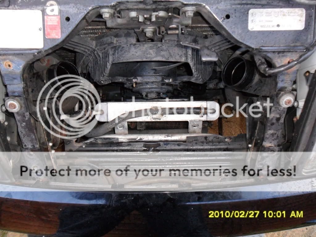

as above, is the electric fan seen here
SAM_0306.jpg?t=1298813749
just for the air con, or does it cool the engine too? as my air con dosent work i was going to do away with it eventually. but do i need to put the electric fan back in now? cheers :-)
its the auxillary fan . kicks in on high engine temp . keep it there as a safe guard .
