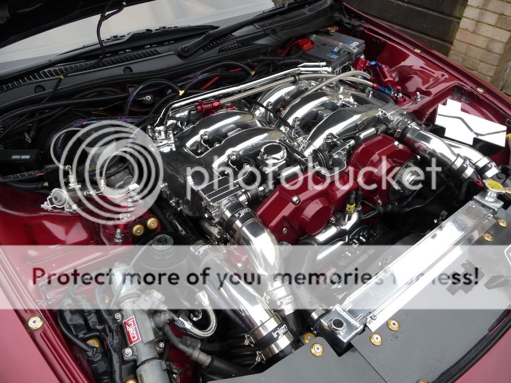

Im aiming for this, but with the cam covers done too, along with the throttle cover

I like that a LOT mate - very cool.

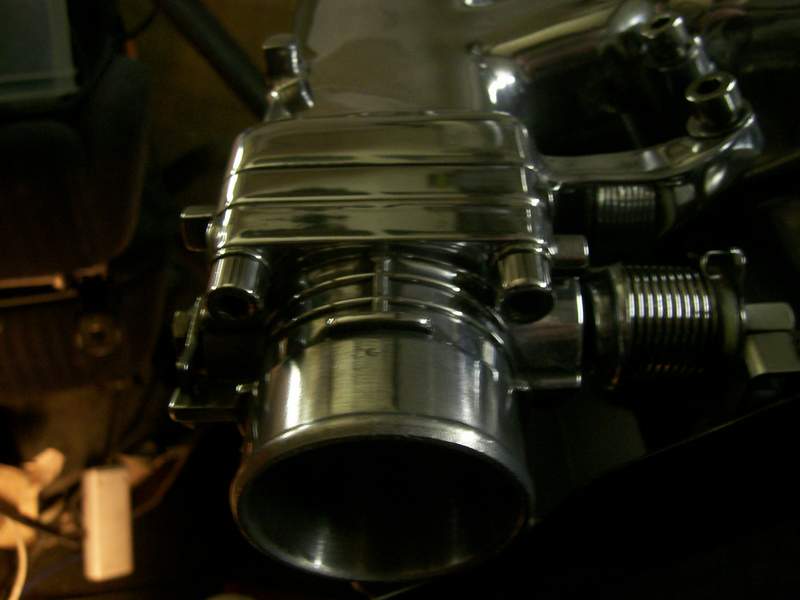

Quick Q fellas,
Did you do the throttle linkages and spring the same way? I want to smooth mine and powder coat it but was thinking of polished throttle bodies and linkages.
Cheers, Rob
Hi Rob, i only used the sisal mop for the springs and link bar, then the softer polishing mop. No need to sand as the metal is already smooth, just dirty. I did take them apart from the throttle bodies, makes getting to the little collars easier, also cleaned the inside of the throttle body and butterfly.
The housing of the throttle body i used an oakley paint/rust removing wheel, which acts as a great sanding/cutting tool to get a smooth finish, but still getting rid of the pits.

Cheers for that Graham, I'm assuming it's done by power drill/dremel?.
On a totally different subject I will hopefully sending you some pods for LED'ing next month.
Yes mate drill, i put the drill in a vice and worked the piece on the wheel like a bench grinder, easier to get the angles.
