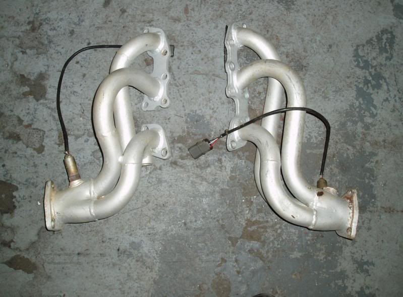

The headers below were recovered from a breaker of ours a few week ago and here they are ready to fit.

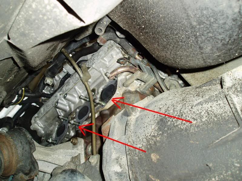

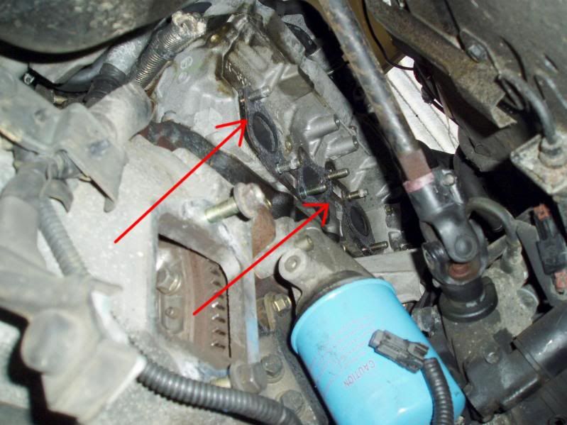

Of course before fitting among many things including the exhaust, starter motor and old standard headers needed removing, here after a few choice words the old manifolds are removed.

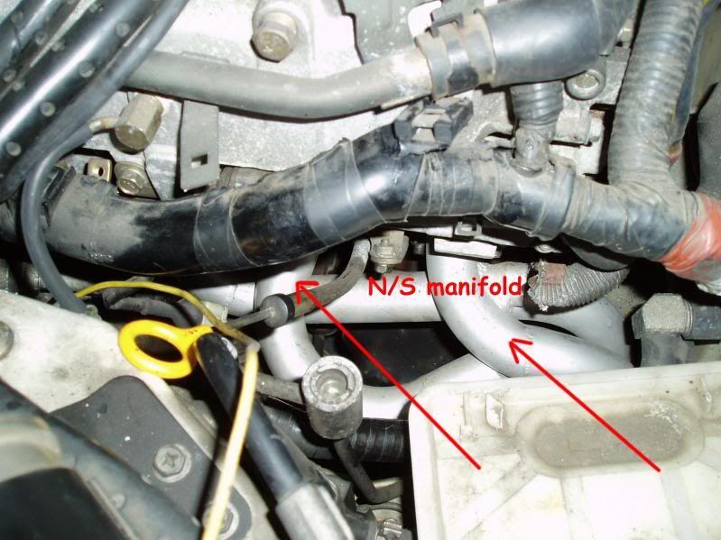

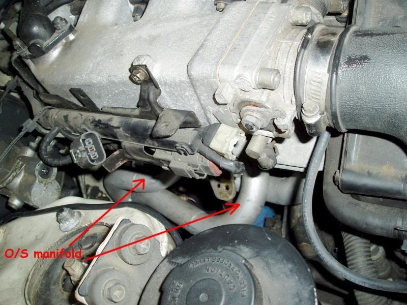

So onwards and the new manifolds are fitted and the view from above is limited..........

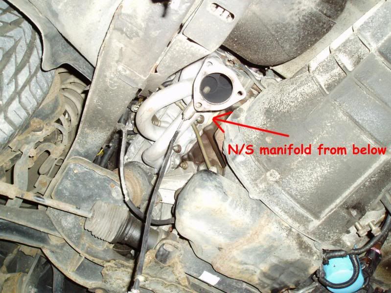

...but from below is more satisfying, just the exhaust to go on, and the pesky steering is very close!! luckily the 02 sensor had already been moved position and the boss rewelded in.
