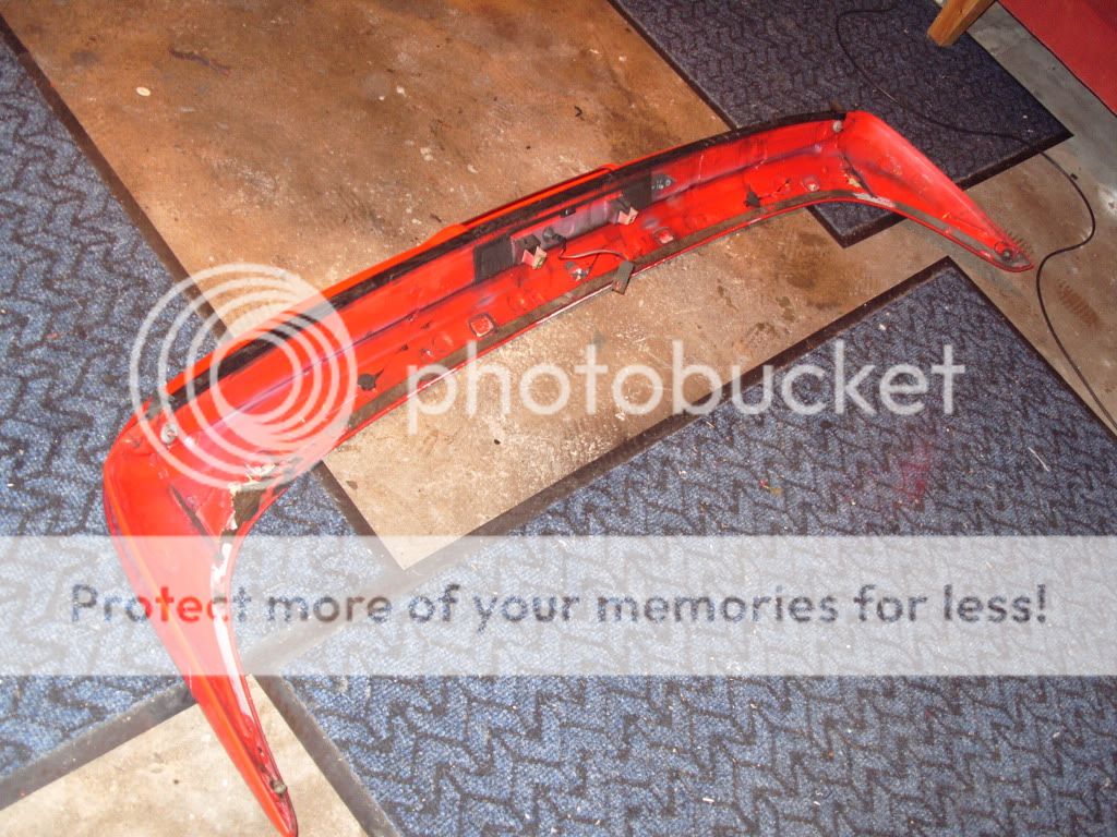

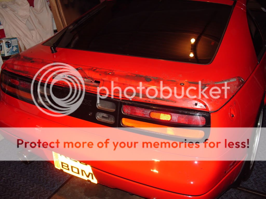

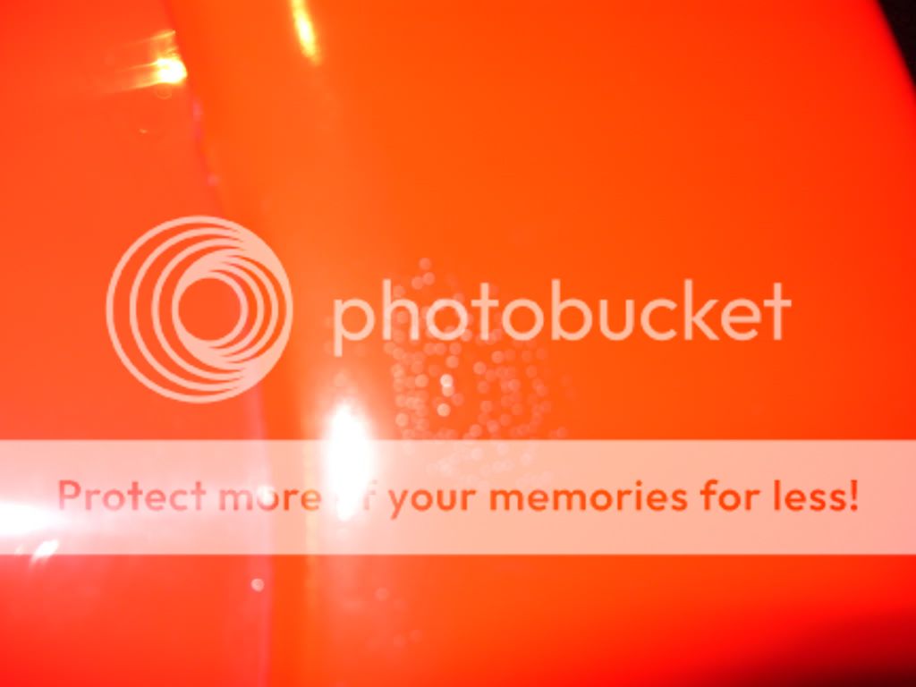

After changing the rubber rear spoiler on my black zed a year ago to the fiberglass one I have now started on the red swb as it was showing signs of blistering.
It took an hour to get it of and its still in good condition but it had to go before it started to act like a sponge.

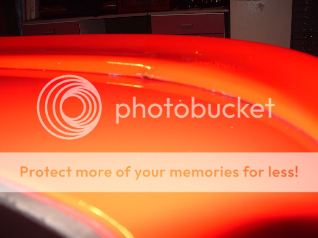

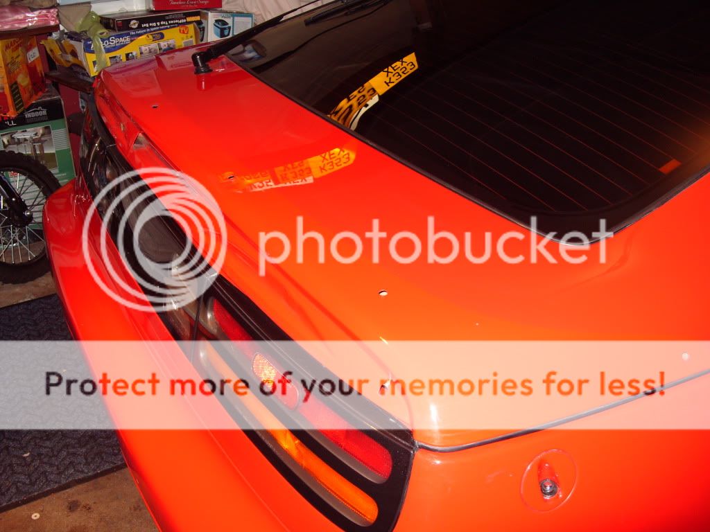

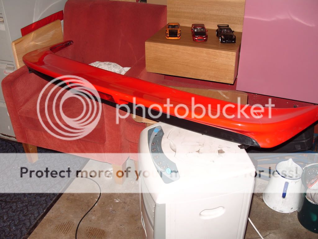

Another hour later and the glue and dirt cleaned of and polished ready for the fiberglass spoiler (thanks Chris) which is at the paint shop getting painted ultra red.
You did an amazing job on cleaning up all the crap that was left, what did you use mate?
Used tcut to weeken all the glue/silicon and removed it with a plastic scraper you need a lot of patience but it will come of.

My only worry about the original rubber spoiler is when it starts to blister it acts like a sponge and will rot your tailgate so get it of as soon as posible mate.
