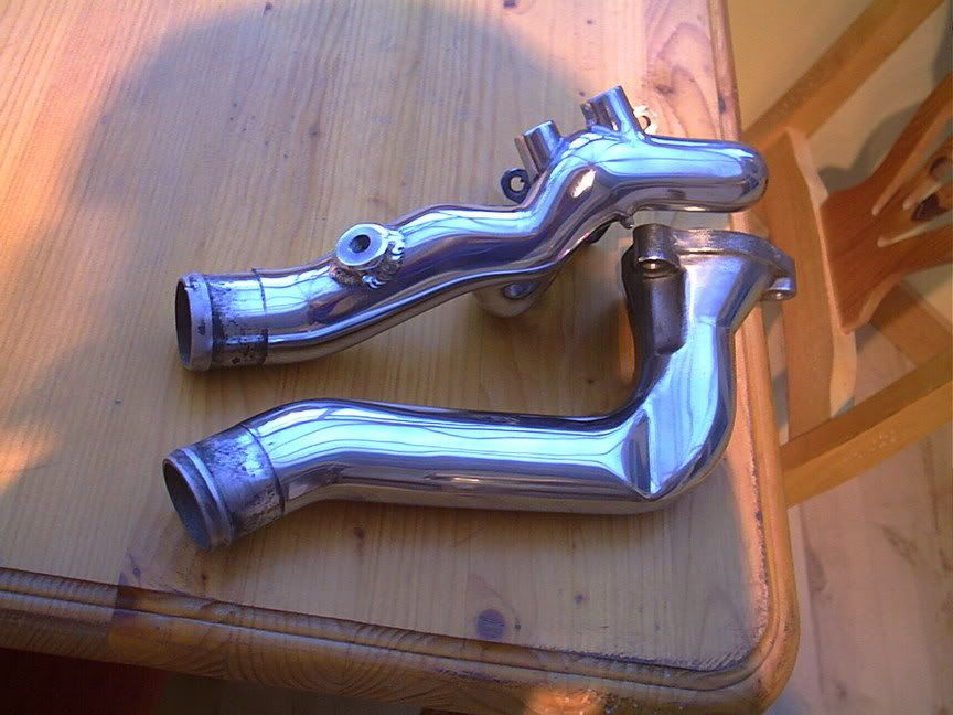

I had a little boss welded onto the top pipe , got it drilled and tapped , jobs a goodun , nice and neat :hyper:
Looks good I might do that. Easy job and save me some money.
Done loads of googling, but seems quite a hard thing to find as the size is generally not listed. Looks to me like its a 35mm hose with 38mm at the end that connects to the rad....can anyone confirm?
Looking at the adaptors they come in even number sizes 32mm 34mm 36mm etc. So I guess its a 34mm then?
Edited by snowleopard
wrong size quoted
The pipe is a different diameter at each end bud , not sure of the sizes though .
